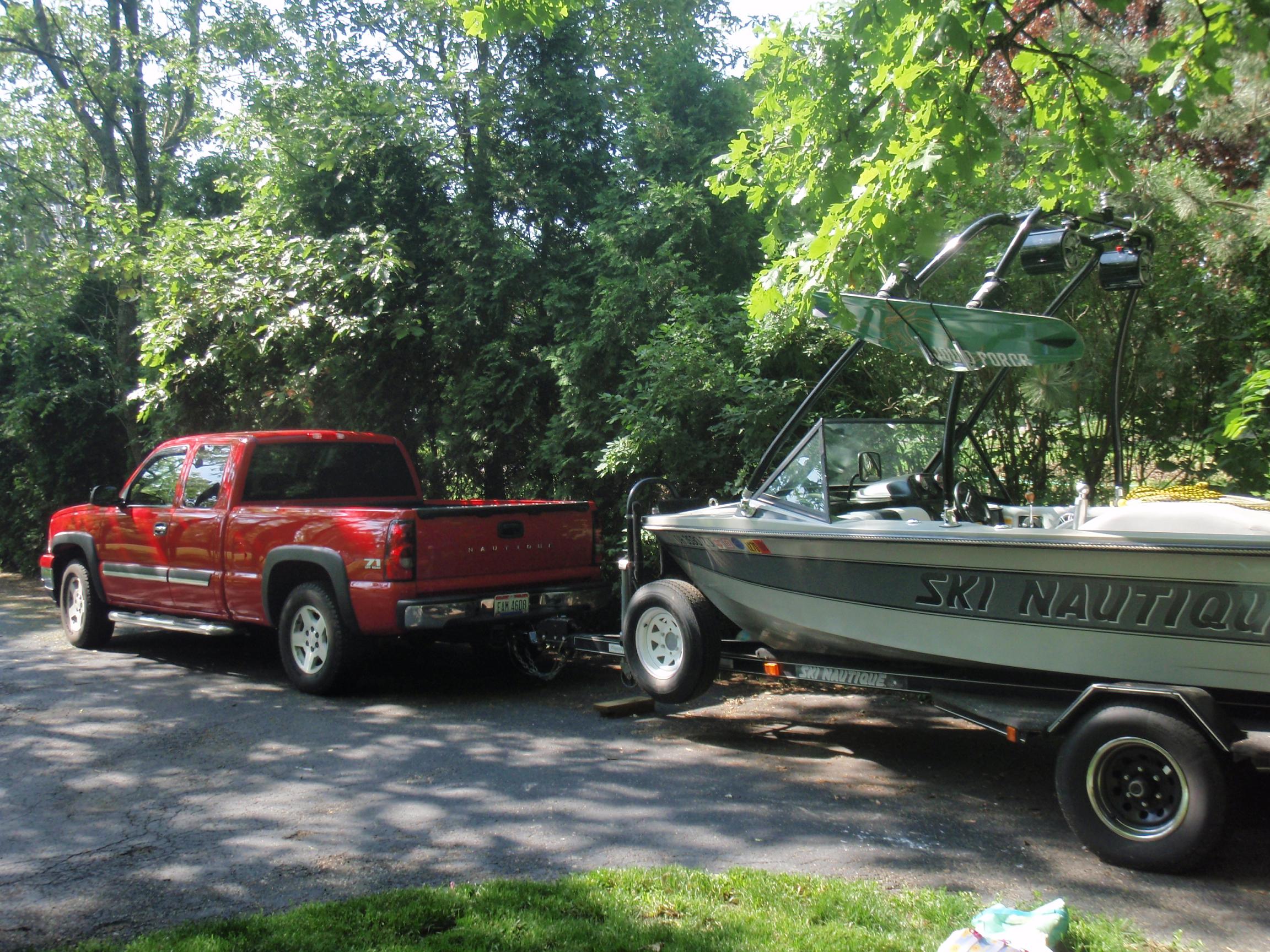

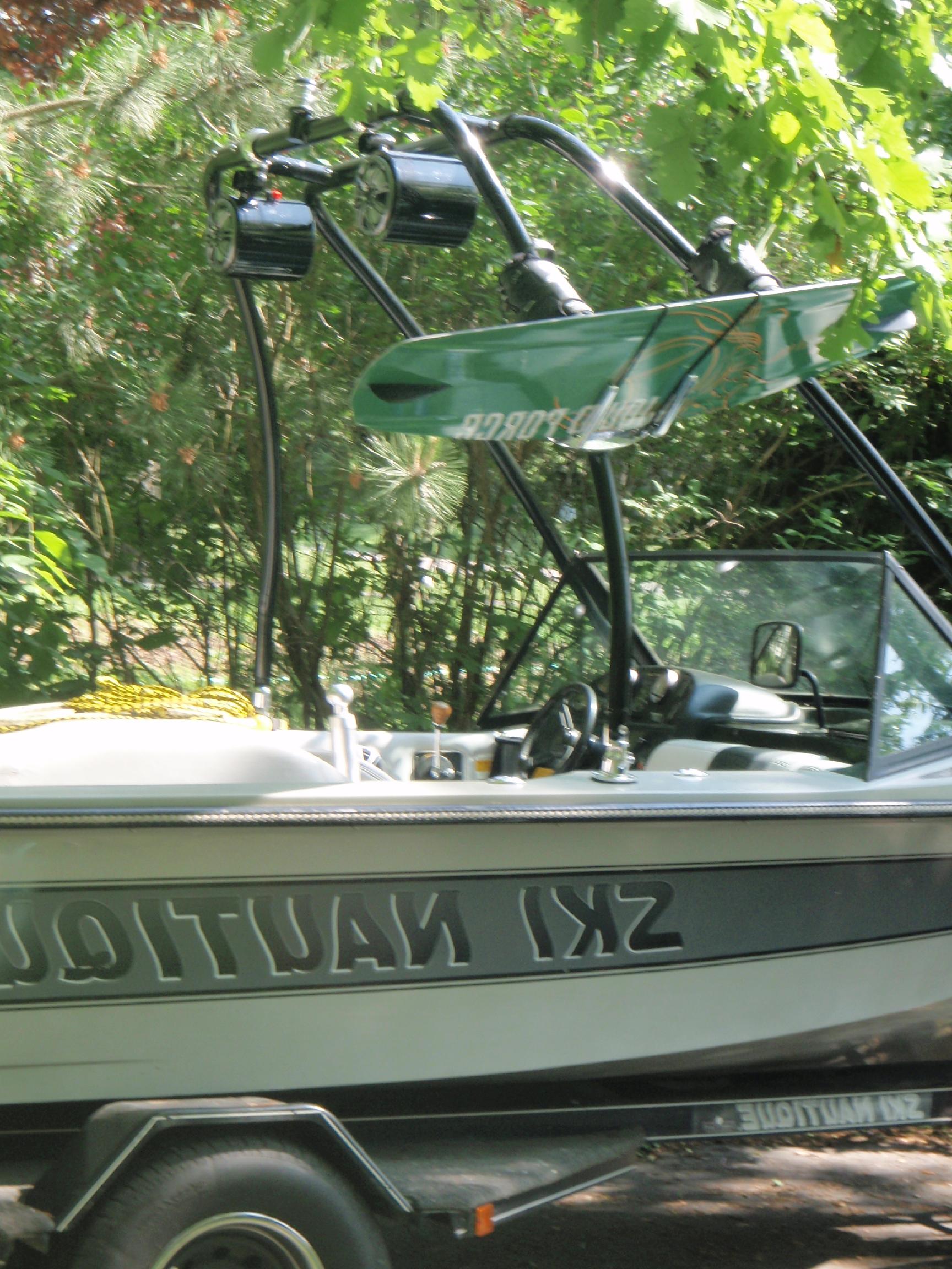

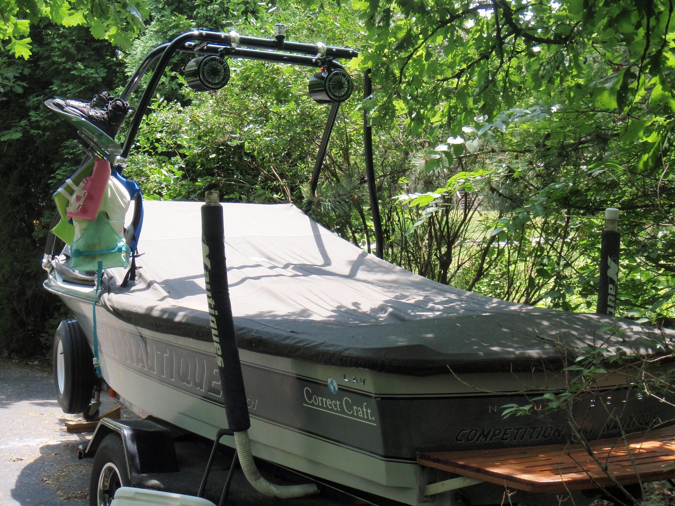

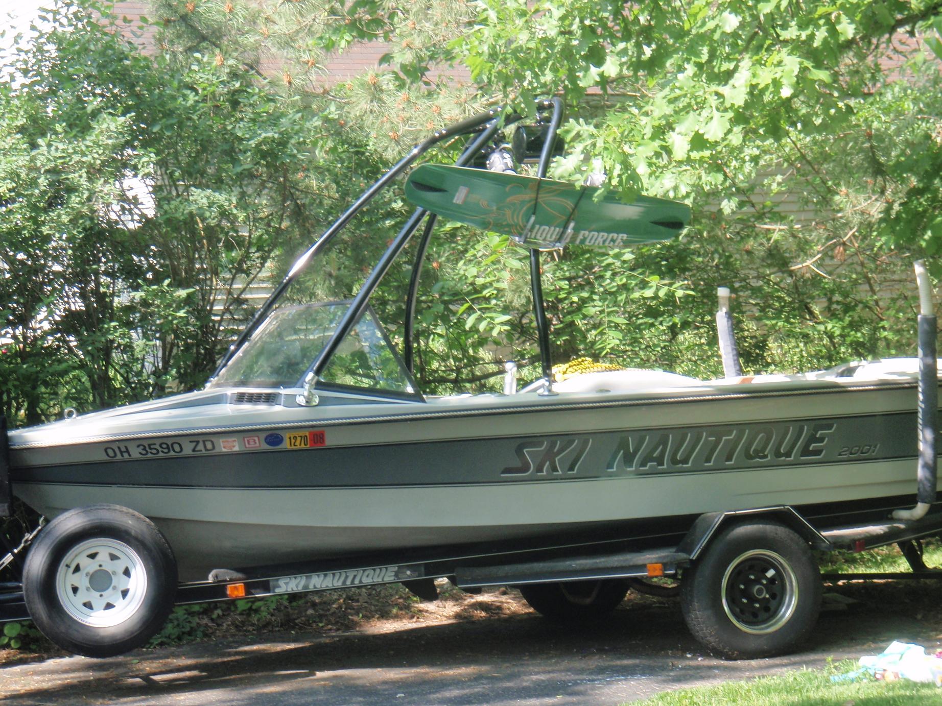

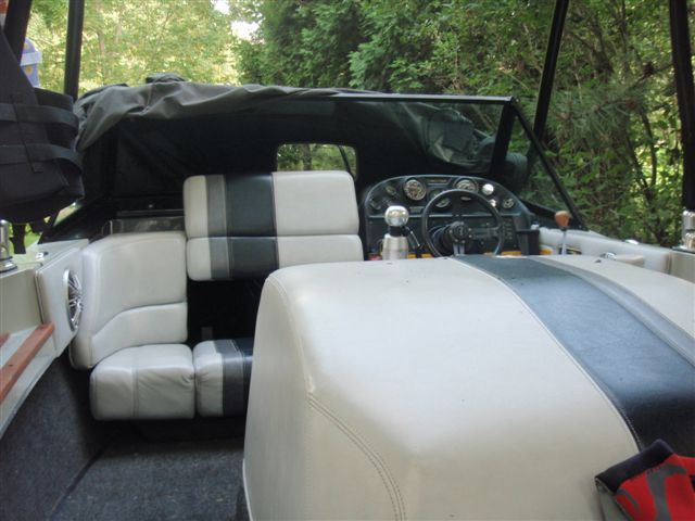

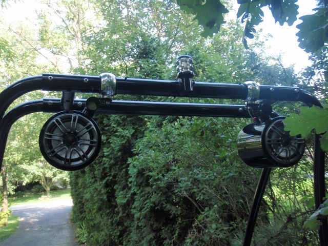

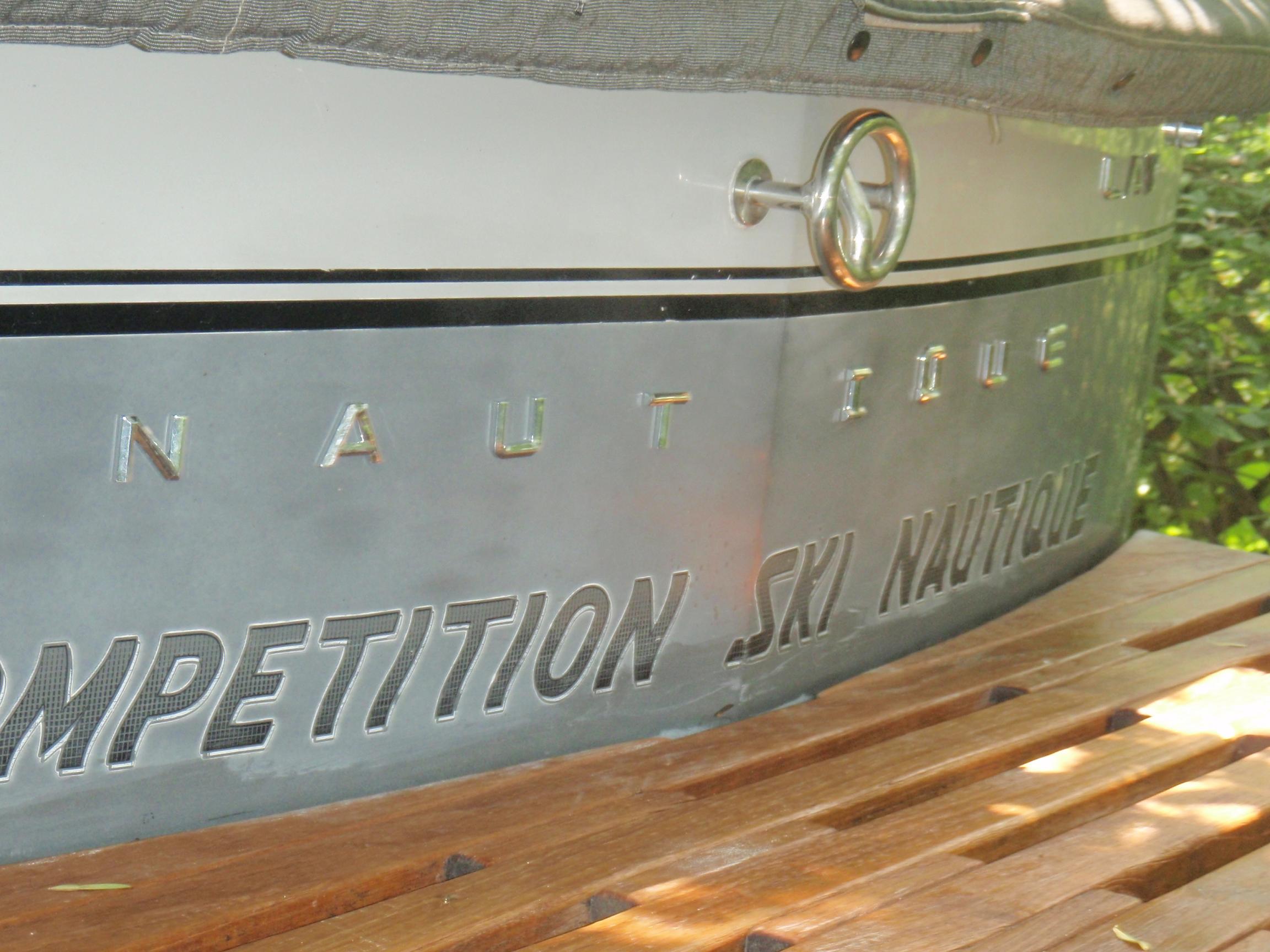

Thats a really nice looking nautique. Thanks for the compliment, bought my from a ski camp, so the boat was in bad shape and I figured why not paint it something different. Ill be redoing the interior and puting another tower on it, got that tower for free so put it on for now.89 ski nautique 2001
Thanks... She was really messy during the "shoot" but it's the one chance I had between getting the girls in and cleaned up, the boat without the cover and still outside, etc. and had the chance and I took it. Thanks for the compliment!

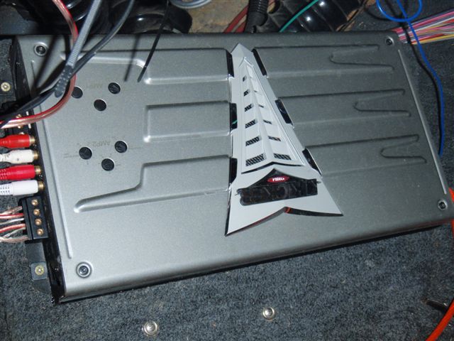

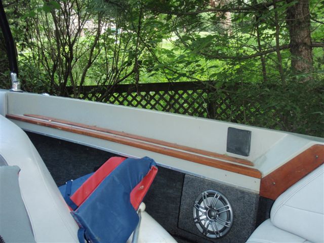

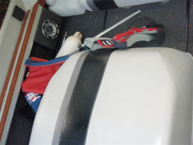

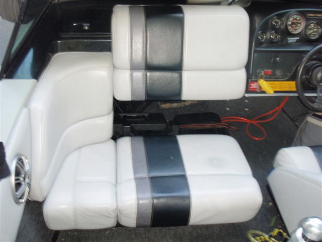

It's hard to make out in the picher, but I mounted my amp to the kick panel right under the steering wheel. That fiberglass doesn't lead to the hull there. So in the drivers seat, if you put your feet vertically you would touch the amp. that way it's off the floor and easy to get to for adjustments. I would be nervous putting the amp on the left hand side with a longer screw. You can see the orange cables in 417 going right from the battery box and then look at the amp pic you can get a good idea.
For the sub box I got rubber feet from the hardware store and screwed them to to the bottom, both to keep the box off the wet floor, and I made the sub fire downwards, which sounds really good. I got my speakers from Polk Direct for 50 a pair shipped, so I've got the two amps, six interior speakers, and the sub and i love it. Sounds great.Travis Fling
