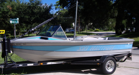

    RE:
    Nice looking rig. You have a similair setup to mine.

      RE:
      Where have you found best place for replacement parts?....it looks much better since i wet sanded with 100 grit and re pinstriped. everyone seems to like the color combo. i learned to ski behind an '85-86 w/ 454.

        RE:
        Skidim.com and www.shopwhitelake.com
        I've gotten most small things from them so far.
        I need to wetsand and redo my pinstripes as well. I have some fairly heavy oxidization on some spots

          1 0 0 grit??

            RE: Re: RE:
            1000 grit, just making sure you guys were paying attention

                RE: Re: RE:
                Meguiars makes a heavy oxidation remover, and Flood Company makes a gelcoat restorer. I have had good luck with both.

                  RE: Re: RE:
                  best gelcoat restorer ive ever seen in my life, my 01 sat on the trailer with the FULL FLORIDA sunshine baking the piss out of it for 3 years straight, i have the black N running down the side too, was completely white. VERT GLASS gelcoat restorer. AMAZING

                    Re: RE: Re: RE:
                    Isnt this just one of those quick and easy cover-it-up products?
                    The only way to get a long lasting shine back is to do it the right way- by removing the faded and oxidized gelcoat at the surface and making it smooth again (ie, wetsanding and buffing). There is no such thing as a free lunch!

                      Re: RE: Re: RE:
                      [quote="TRBenj"]
                      The only way to get a long lasting shine back is to do it the right way- by removing the faded and oxidized gelcoat at the surface and making it smooth again (ie, wetsanding and buffing). There is no such thing as a free lunch![/quots
                      somewhat yes, but i dont have the time to be BS in' with all that ya know? its a good cheap fix
