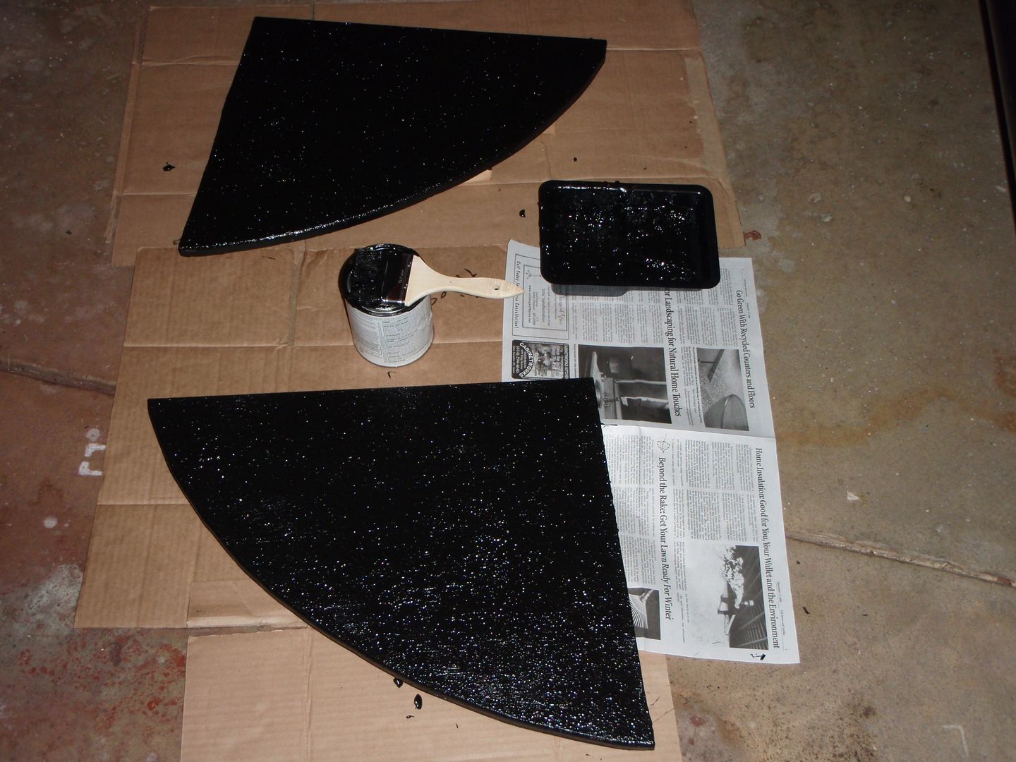

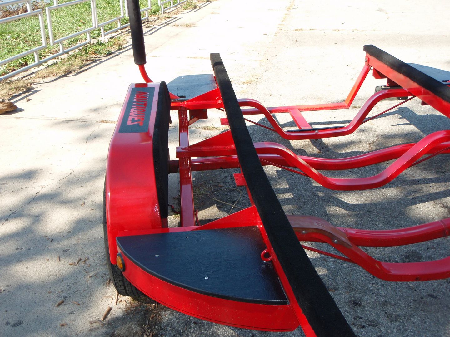

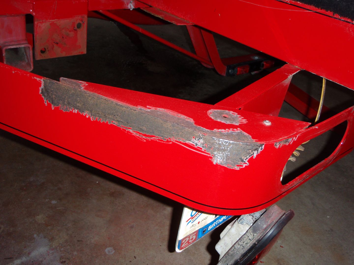

                      When you pull the carpeted steps off the trailer you may want to put something back in place of the carpet. As a flat surface that doesn't drain well the carpet holds moisture against the trailer and we all know the result. I ground off as much rust as I could, primed with rustoleum and repainted, then replaced with rhino-coated plywood. Very nice, as it dries almost immediately once it's out of the water. I kept my templates so if I run into problems with the wood I can easily replace them. I'm sure there are better replacement options (I've yet to find a decent one yet, tho) but it's a much better solution than going back to the carpeted steps.
                      Looks like you have a great project! Cleaning it up will do wonders!

                          Great Idea with rhino lining the plywood instead of doing carpet!!! I need to replace the fenders on the trailer unfortunately, any ideas on where to get replacements?
