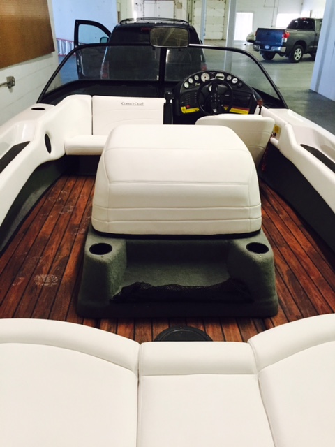

    Here's a few pics of my job. Aqua Tread marine flooring used.

    Looks sweet. How was the flooring to install?

      Thanks. It went well according to my installer. Had good convo's with the manufacturer prior to installing, used suggested adhesives and filler, and I guess wasn't an issue. Happy I went with this instead of carpet.

        Nice. I looks like real hardwood..

          Thanks. I've got this floor in my tooner just a little different color combo. Works well. Great alternative to carpet.

            Clean . I love the white I hope its not too much to keep it up.

              Wow...that looks great! What is the flooring? All white w/the warm floor is a great combo.

                Thanks. Exterior of boat is purple so purple embroidery of correct craft inside. Flooring is Aqua tread marine flooring by better life technologies. Bennington uses it as an oem offering

                  I love that flooring it looks so good.

                    I wonder how hot the flooring would be on a hot day on my kid's feet? Way better looking than carpet. Looks good with all that new interior as well.

                      Thanks. Heat depends probably a lot on where you are as well. In Minnesota the floor wasn't too hot. However if you were in a southern state I could see that being an issue. Last year there wasn't a time where I or my kids couldnt walk on it.

                        How hard was it to pull up the old carpet? Looks great! I love the white vinyl...very classy!

                          i had the whole job done by an upholstery company in Mpls area who does a lot of boats, but i did speak with him on how it went. He said no issue. Before i started this i had asked around on a couple forums (correct craft fan too) if anyone had done this and used a vinyl type floor.
                          Found a lot of opinions on how to do the work, but nobody that had actually done it. One dude said i was going to have to gel the whole floor prior to laying this down. Oddly enough, he was incorrect. they smoothed out the floor with some sanding, then used the recommended ahesive, bam.

                            aqua tread flooring looks great, nice job.

                              I like it! Is this colorTeak dark strip or Mayan Teak? Thanks
