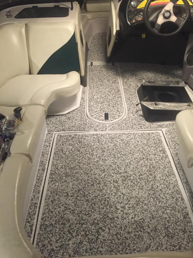

Finished the seadek project tonight. Overall I think it went well. I'd give it a 8/10. A few areas where I need to touch up the Monstaliner and a few rough edges but light years away from having carpet in my boat.
Wow. That's looks awesome. Nice job and thanks for sharing. I wish I had the skills to take on a project like that. OR even knew someone that could assist
