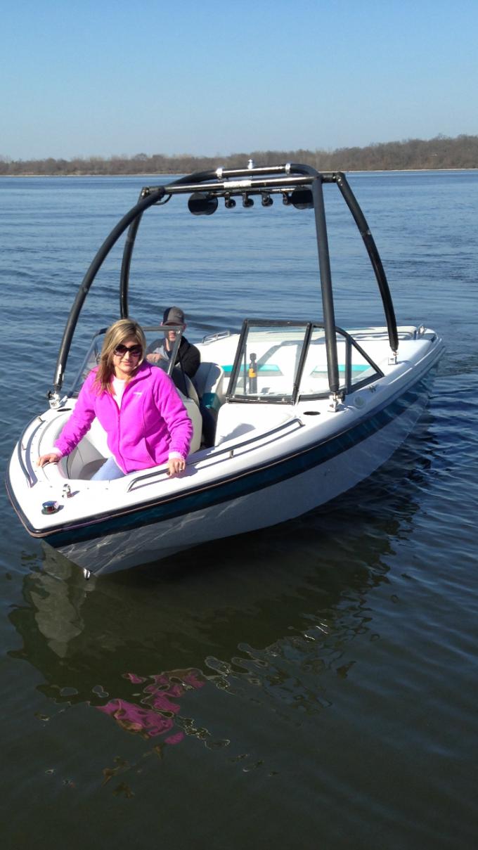

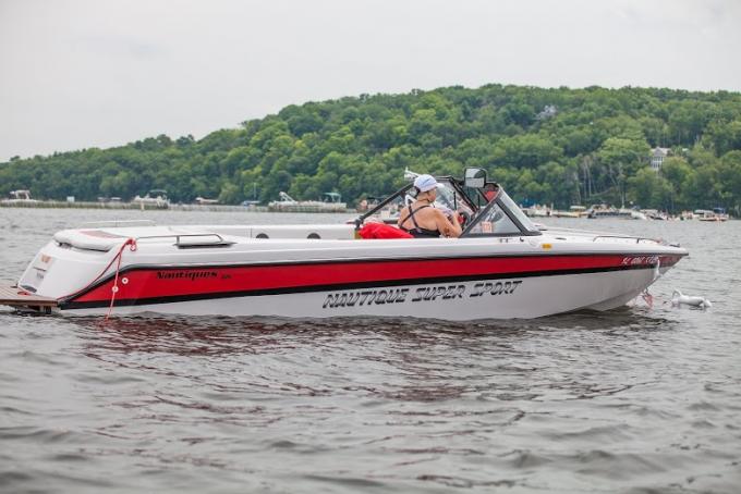

      Originally posted by Tryathlete View Post
      Hope you can get it running and come to Green Lake for the annual reunion. It would be nice to have another Super Sport there!
      semi annual,this year is just a small gathering of regulars
      I was the only SS last year,and one of 2 at Quinners

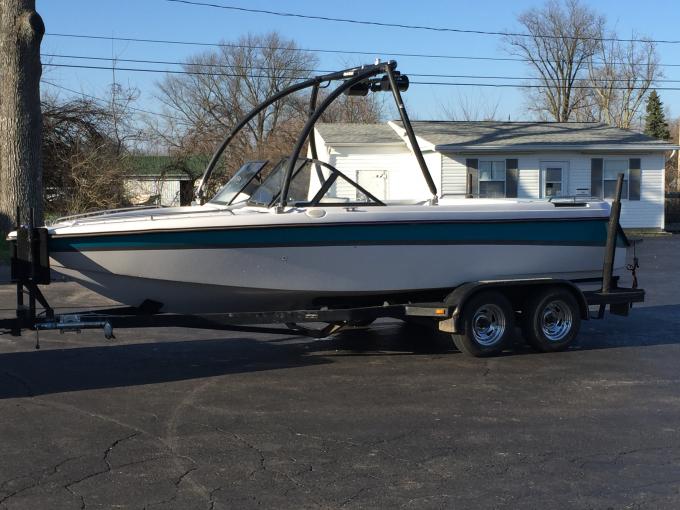

                  Nauti floats! My insurance auto auction flood boat is almost ready for the season seemed to run good. Got a couple minor details to take care of but I think we are good. I have been waiting on this day!

                    Looking great!

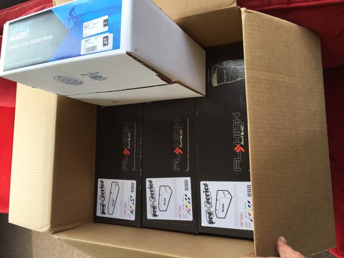

                      Christmas came early!! The guys at wakemakers were awesome!!

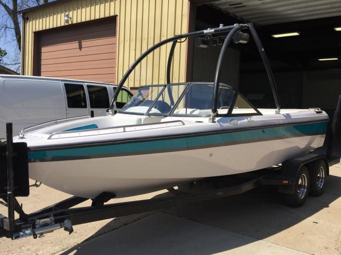

                        I also recently had the boat buffed and polished. I was really happy with the results! In the right lighting and if you are looking for it you can still see where the old lettering was. Next winter i may try and wet sand some of the spots but it really isn't bad at all. And for now i like it decal-less.

                          Looks great so far!

                            you've got skills my friend...thanks for sharing! I kinda like that naked look too
