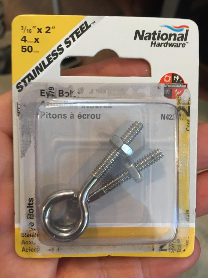

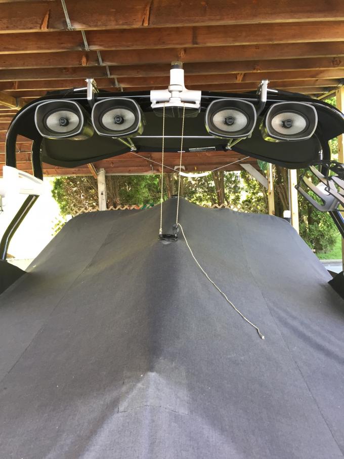

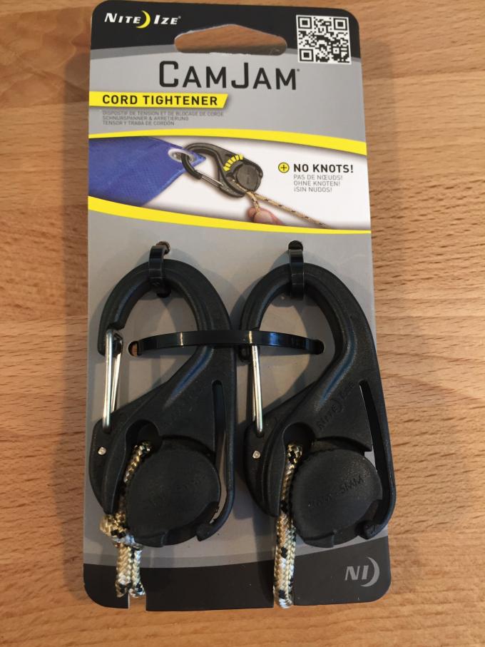

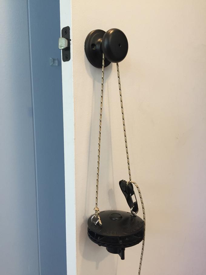

    I still need to tweak my setup, but figured I'd share. I didn't want to pay $50 * 3 to install hangtytes, on top of the fact that I didn't want to loose the ability to use my pole supports, so I modified what I had. I simply drilled two holes in the boat vent, installed some eyehooks and used CamJam's to give me the ratchet/holding action. Entire project was done in about 30 minutes for under $20.

    Slick setup.... but that vent doesn't grab anywhere the same amount of material as the Hangtyte does.
    the Hangtyte pressure grabs roughly 1.5" of material around a ~3" circle.
    Your method relies on a single sewn seam? On a vent not meant for those loads..... I man crank hard on my Hangtyte... In order to pull the material up really tight. Never an issue with ripping material, it uses a teeth/clamp method to grab the material and spread the force over a larger area.

      Based on this image of a hangtyte (https://lh3.googleusercontent.com/3A...m0FKMIlkiWE=s0), it seems as though the hangtyte and the boatvent clamp to the cover in the exact same way (not sure what you meant by a single sewn seam (Unless you were referring to the mini-pole that supports the back of the cover between the lockers)? All said, I doubt the loads from hanging vs being pushed up by poles is any different. I've only had it on their for a day, but it seemed solid...

        Ok, we must have very different covers.
        on a G23 the vents are just sewn in and have nothing to do with pole supports from underneath.
