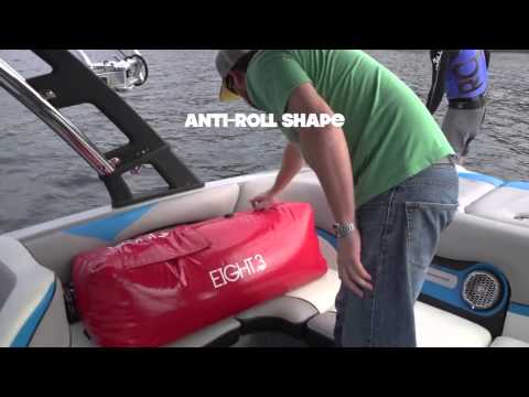

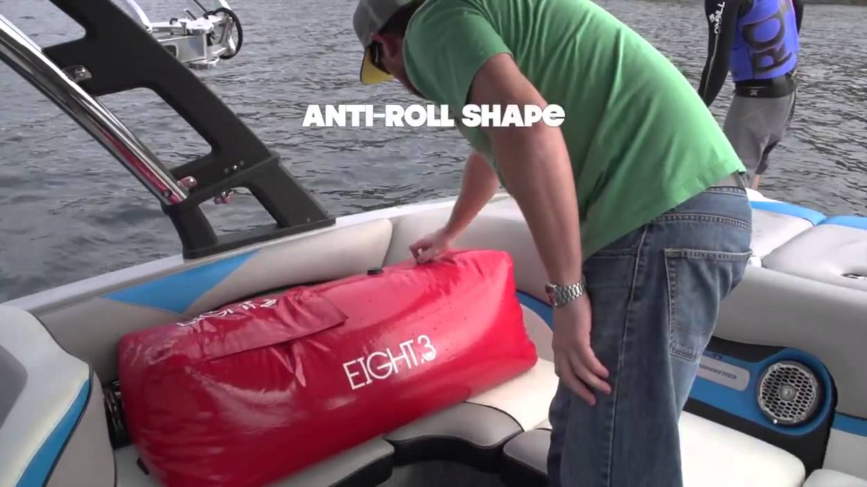

                        If I were you I would wait and see what that new Ronix system is like. On the surface it looks like it would be the perfect thing for surfing. 750-1000 lbs and fills and drains in 90 secs. you could buy one and move it from side to side as still have if ready to go in less time than one fat sac.

                            Ronix just announced a new ballast system at surf expo called the Eight.3 system. If you google it, wakemakers has a short you tube video of it draining. Not much info out about it yet, but should be coming out in the next few weeks.

                              Here is a video, shows both bags next to each other. No word yet on price.
