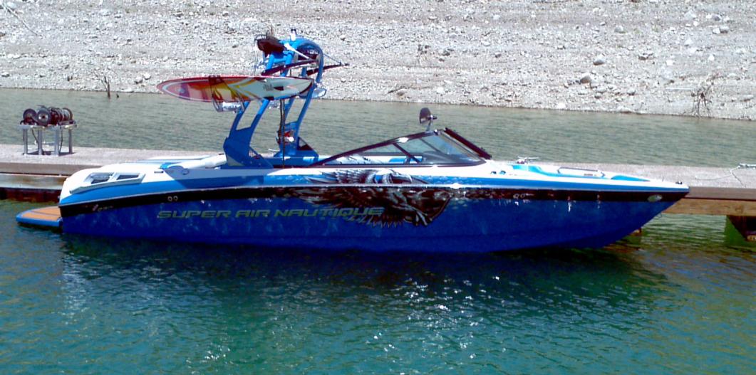

    Hi all, I want to upgrade my factory ballast to create a long, large, deep wave for wake surfing. I have heard of people achieving a wave where sweet spot is 10-12 feet long and can ride 20 feet behind boat. Want to shred up and down the wake. Mostly ride on port side. Generally 3-4 of us go out.
    Questions:
    1. Which size fat sac (length, width, height)? What weight (lbs.)?
    2. Should I integrate with factory pump? Or use Tsunami pump?
    3. Should I upgrade bow/belly ballast as well?
    Any other tips would be greatly appreciated?

      If I had your boat I would get the complete piggyback upgrade system from wakemakers for both the front and back of the boat. Open bow sac for the front and 750's for the lockers. The kits come with all hose, clamps and connectors to plug and play with the factory pumps. Then I would get one 400 sac and a tsumani pump. That bag would go on the seat of whatever side you want to surf.
      To ride on the port side, I would fill the belly and bow sac, starboard factory, port factory and 750, then put 400 on port seat and fill enough to get the rub rail close to the water. Try not to go past the rub rail becasue you take water on through the vent. A friend of mine with a 230 actually tapes off the vent so they can cant the boat even farther.
      If the nose of the boat is way up in the air, you will get a really tall short wave. The more you lower the bow the longer the wave will get. that's why you still need to have some weight in the front even when surfing. Then just play with the belly ballast and speed to get a wave you like. Speed should be somewhere between 10-11.5
