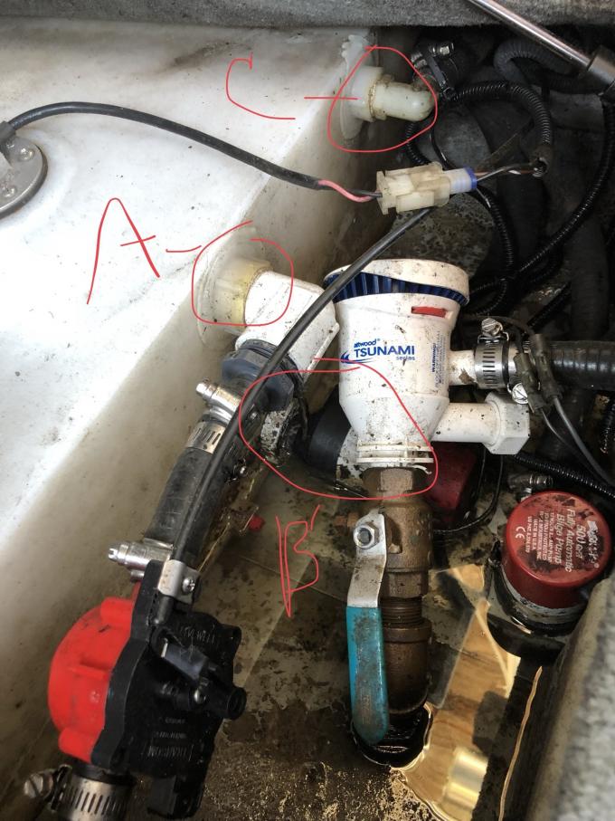

    I am interested in plumbing my new bow sac to piggyback off my belly tank in a 2004 210 SANTE.
    A is my fill port, B is my empty port and C is my overflow port.
    Does anyone know can I do this with this set up and if so what is the best way?
    Will I need to use check valves and if so where?
    Wakemakers says I cannot but I have heard people doing this in the 2006 model.

      The reason some 06's are piggy backed is because 06 is the first years 210's started using jabsco reversible ballast pumps.
      I don't think you can do with your set up.I believe you'll have to add another pump for additional ballast. I'm not sure and I do not have your ballast set up. Wakemakers does have the directional Y valves that you could maybe install at your pump but you'll still need a pump to drain it. If I were you and wanted this I would install a jabsco reversible pump to the bag with its own switch and overflow out side of boat . Done

        Ok, I would certainly do that does anyone know the best way to plumb, mount the pump, and wire that set up.

          Thanks Cpohl. I actually have a 2003 direct drive air 216 with the rear ballast and I was hoping I could piggy back to the hard tanks in the trunk. I was told same as you from wakemakers that Nautique changed the pumps in 2006 so it is only available from then on. I was thinking along the same lines as you and hoping that someone else figured out how to make the stock system work.
