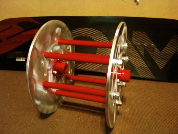

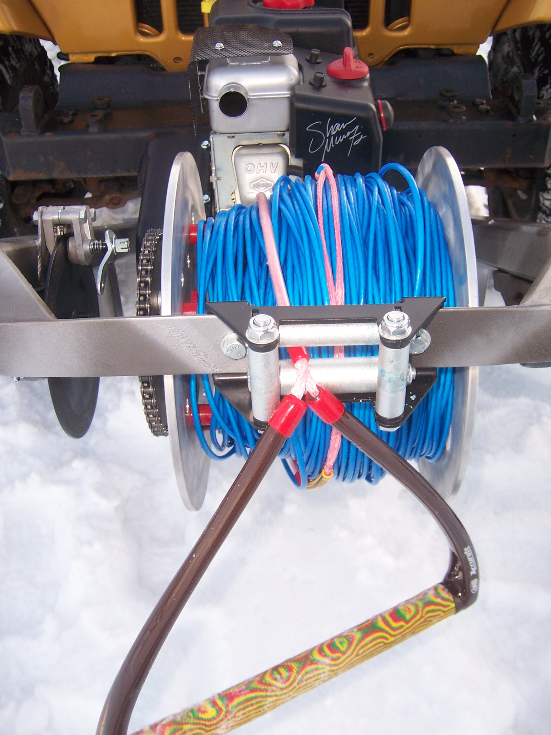

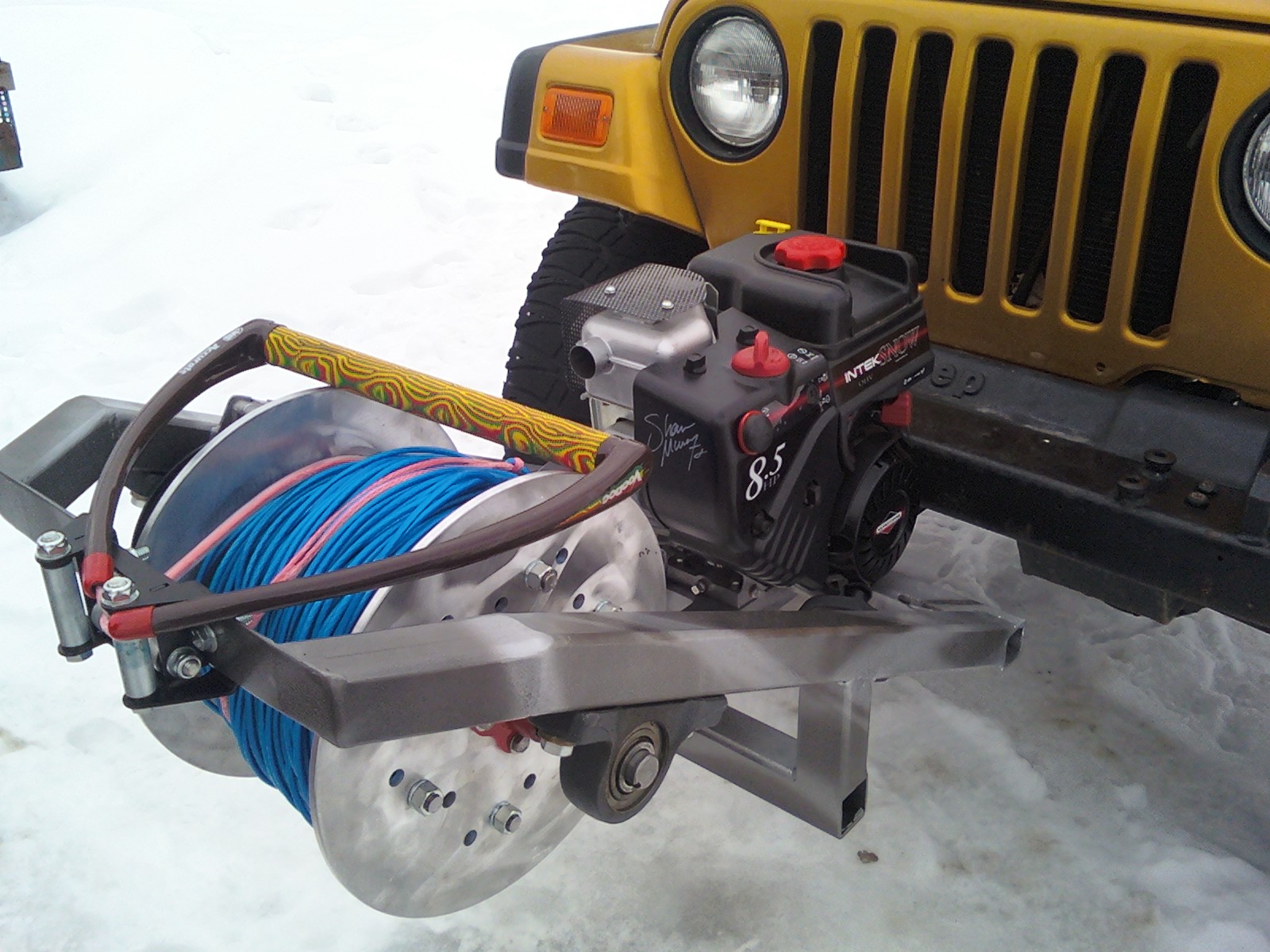

    So with summer aproaching, my buddy decided to build a wakeboard winch. We had it out for its maiden voyage yesterday and the thing works great. He couldnt have done a better job on it. Its a 8.5 hp briggs with 600ft line ans its set up to pull at 20mph. check it out

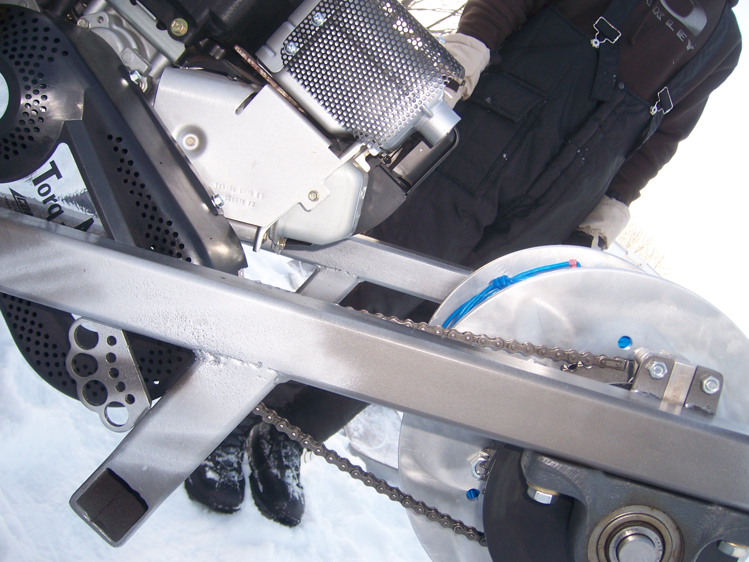

          what size sprocket are you using? and do you have a cc clutch or tav? inner diamter of spool? is the engine slidable or fixed? it's a great low key design.

            motor is fixed. its the tav2 . the drive sprocket is 10 and the spool sprocket is 48. inside of spool is 8" and its 9" wide. Sometime he is planning on mounting a plexiglass sheild and diverting the exhaust twards the ground.

              have you tried deep water starts ever? i'm thinking you'll need a bigger sprocket. the inner diam. sounds perfect. with a tav you should totally work on a releasing spool. other than that it all sounds and looks awesome.

                    definitely the best way to spool it is to get the line out almost as far as it will go while still having a couple tight wraps and cut back and forth.

                        winches are very easy to operate. i don't even have a brake on mine(wish i did). if you have a brake instead of cutting the engine off and letting go of the throttle you can just cut the throttle and hit the brake, leaving the engine running and not cranking it after every fall. they are the most cost effective pull out there.

                            Right now we just cut the throttle about 20ft away. My buddy has a disc brake on it(pics above) but its not hooked up yet. It will be handy once it is though. Cant wait to water test this thing. Im possitive we will within the next month and i will post a vid, and let you all know how she does.
