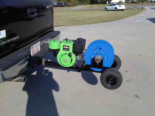

    I have been using that site for some help on my project. I have just about finished.

      Very nice! That site seems very helpful and i've only had a chance to breeze throught it for about 1 hr. If you don't mind me asking how much cash have you put into your project?

        I am using an old Briggs 8 HP motor that I bought from my dad for $100. The most costly part was the torque converter. I did buy the spool off ebay as we found it was just a cheap going that route. I got all the hubs and sprockets from a friend who used to race go carts and has a ton of older stuff just laying around. We actually made the spool quick release to help with pulling the rope out. My dad has a small machine shop and welder so we got to practically everything ourselves and used scrap pieces of metal on the frame.
        All in all I think will have about $500-600 or so in it, I do think its better than some you can go out and buy. I tried to design it more like the ridiculous winches on where the rope comes out the bottom and the spool spins opposite of most you see.
        Were gonna use it for the first time today so hopefully it all goes well!

            It went pretty well for the first go at it. Since the engines kinda older (I would guess at least 20 years old) we are going to put a rpm gauge on it this coming weekend. Keep an eye on ebay for torque converters, thats where I ended up spending the most money. I got the rope from a place from the winch site, it came from Washington State. They give a discount for anything over 600 Ft. I went ahead and got 700 ft. I opted for a larger 8 HP motor because I weigh about 215 and my brother is up about 250ish. I wanted to make sure its enough for both of us. Were gonna play around with some different gearing this coming weekend and fine tune it, but for the most part I was really happy it worked after all the hard work we put into it.
            Good luck with your build and if you have any questions I will answer them as best I can
