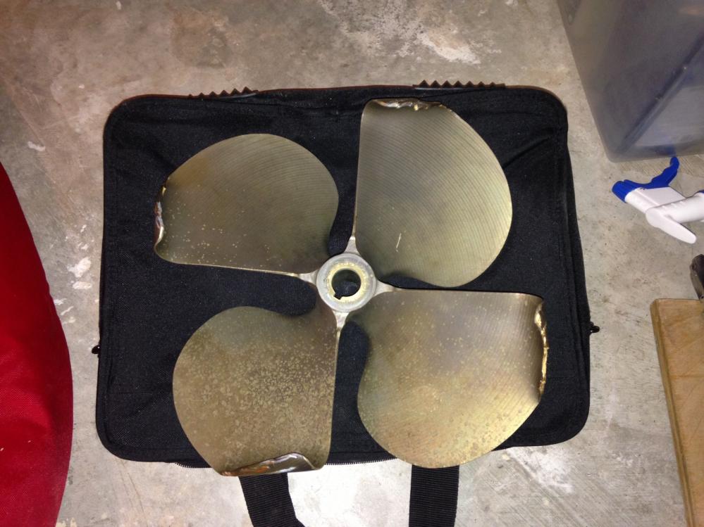

                      So God taught me an overdue lesson in humility (for taking pleasure in the mishaps of others at the launch) and patience (for getting impatient with my pregnant wife for having to go to the bathroom when we got to the launch 10 minutes after she went at our house instead of helping bump the boat off the trailer first) last night. From now on, I'm floating the boat off the trailer.

                        Oh Man sorry about that. That is a sick feeling when you hear/feel that prop hit.

                          Here is the crazy thing. I was about to pull the boat immediately out of the water and check on the prop, but was in a state of denial (as in, maybe the prop just tore up the bunk and didn't get damaged)... I'll test it and see how it feels... Right....
                          Well, I ended up taking the boat out for 1 run. Pulled a guy slaloming at 29. Wake was normal. Virtually no vibration. I don't normally pull anyone that fast, as this is the first person to slalom behind my boat since I bought it, so I could not really say whether the boat was working harder or not. My wife riding in the passenger seat could not tell a difference. But I could hear it. Slightly different sound. When his run was done, I went into the water and felt the prop with my toes. Then I had that sinking feeling again and could not believe what my toes were feeling. Not so much that I was surprised that the prop was torn up, but that the boat still handled so well. My damage was pretty even on each blade I guess.
                          Another lesson was learned here. While I carried a spare prop on the boat and prop puller and wrench for the castle nut, I didn't have any cotter pins on me (I had left them at the house). I also did not have a hammer, a block of wood, and/or a rubber mallet. I was able to trailer back home (since I live so close) and change props and get back on the water in about an hour (got the old prop off easy, but getting the new prop on was not so easy... getting the prop forward enough to get enough access to the cotter pin hole took some major cranking on the castle nut). So, if you're going to have a spare prop on the boat, carry ALL the tools, cotter pins, shaft key, and spare castle nut or the nylock nut alternative as well.
