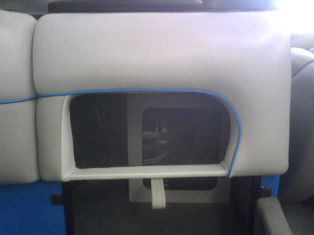

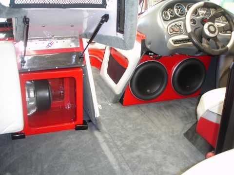

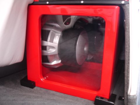

I know that Earmark Car Audio had built some nice vents for a 220 install not too long ago, so you may check with them to see if they have anything for the 210; I seem to recall them saying they sell the vents. Here's the link to the 220 install....about half way down are the pictures, so maybe that'll give you some ideas.
http://earmarkcaraudio.com/install_superAirNautique.asp2001 Air Nautique

I was wondering if anyone ever got in contact with earmark about that cooler door replacement grill for the 220 sub location. If so how were they to deal with and how much did it cost. Thanks in advance.---K.B.1990 Sport Nautique
Yep...ordered one for my 220. Susan from Earmark was very nice and easy to deal with. It was 260 shipped. Had it in just over a week.
I had one made at a local plastics fabricator that looks identical to the one Earmark makes. It cost me $130 with tax and it works perfect. You can hear the sub very well.

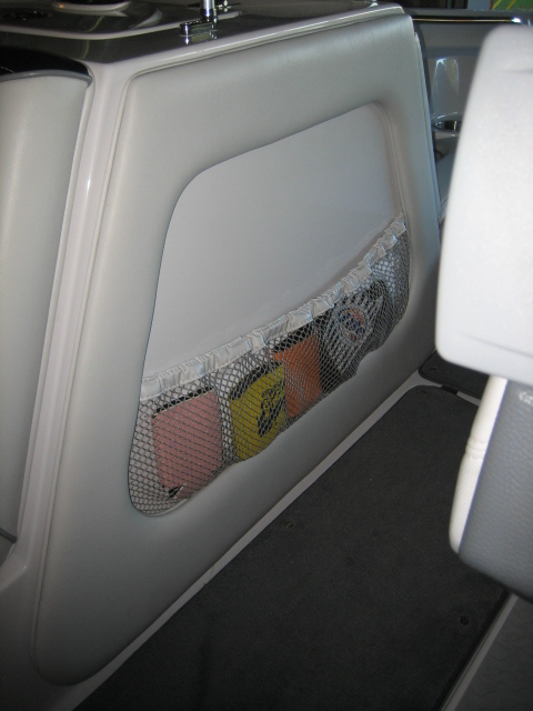

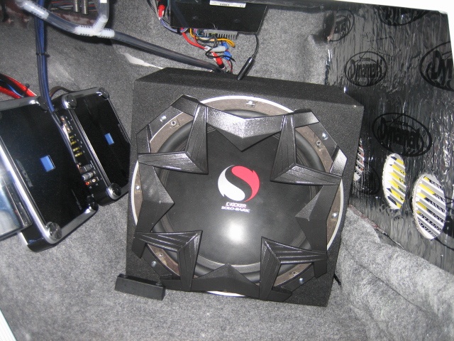

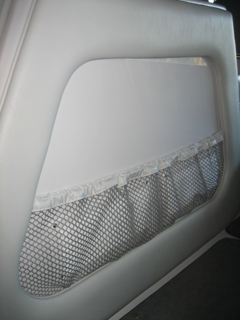

Here is my solution to the original problem of trapped bass. It's by no means a professional install, but i only had to spend $30 for the vents and dynamat. I just cut 4 holes with a hole saw and I'm finally boomin. It was an inexpensive and easy way to make your system sound a lot better. After covering it up with a few koozies, you can't even tell its there.
