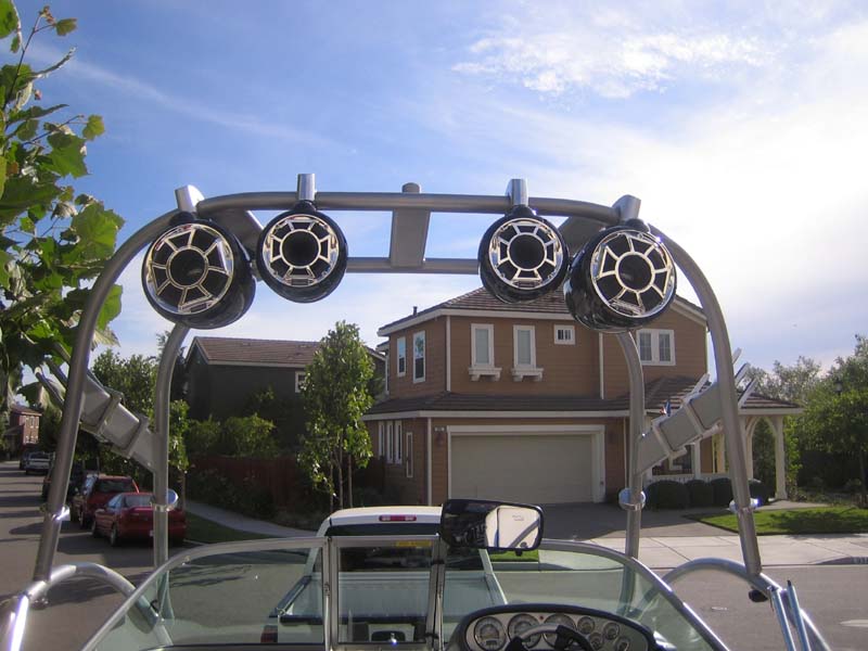

                          i have the Pro 60's and MB-8's running together and it has an amazing sound the 8's really give a good mid bass punch most boats are missing, i have not heard the 485's but i understand they are f-ing loud but beware you will want a ton of power to run any of these setups.
                          Our Setup
