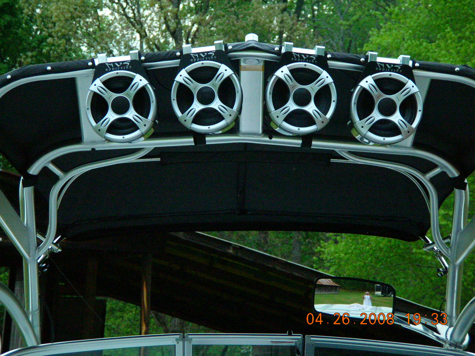

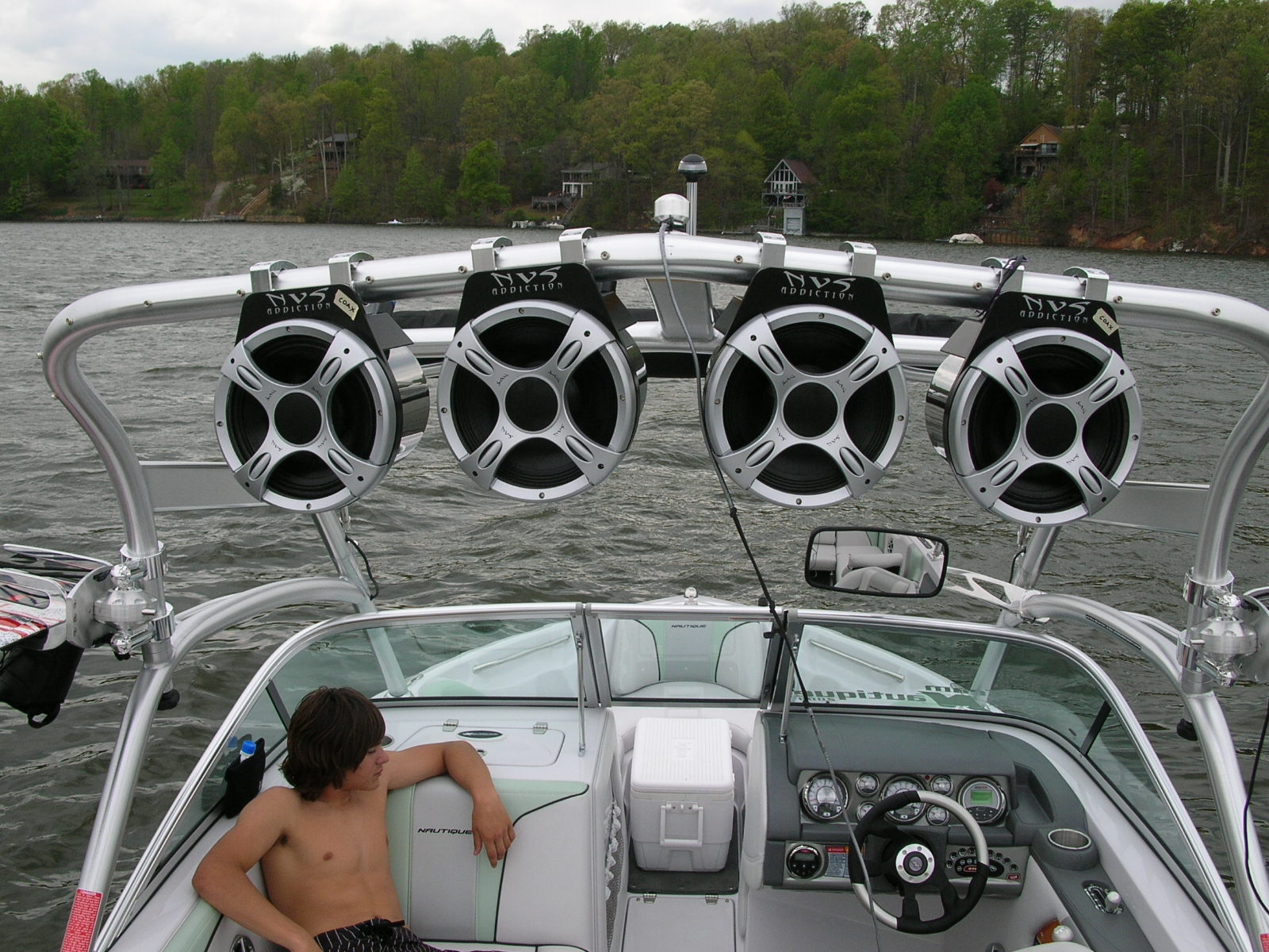

          Not Wetsounds, NVS set up
          Here is our NVS set up and they are great, we love them. I am 5'11" and had no trouble hitting my head. One picture shows the set up with the Bimini up.
