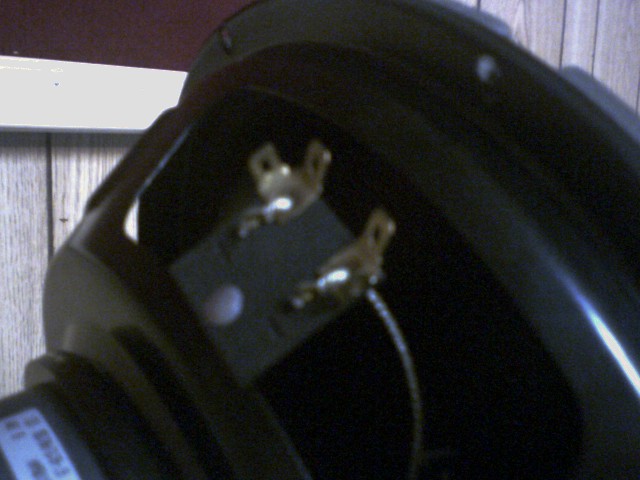

                      heres the subs connectors.
                      Like I said in my other thread, I installed the sub and amp last night, I'm very pleased with it so far. I still have to hook up the 6.5s though
                      Any recommendation on setting the crossovers?

                        I think that still just counts as one connector since they're going to the same wire.
                        Anyways, on your crossovers set the sub at 100 and the tops at 80. The crossover point you select isn't where it stops producing sound, that's where you've got a 3db dropoff, so it's not an endpoint, it's just where the majority of one signal or the other goes. I hope that makes sense, but you're tops can produce sound down to probably 40-50 hrz, but they're just not efficient there, or at least as much so as your sub is, so let each speaker do the work they're supposed to do, eh?

                          I was wondering if that counted as 1 or 2, since it was the same connector. Anyway, I guess its a single voice coil 8 ohm then. Anyway, its ran to the 1/2 channels bridged on the amp.

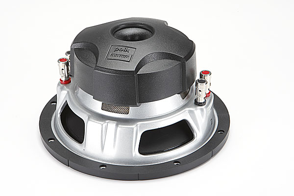

                            DVC sub
                            Ah, great question and I should have specified. 100hrz, and 80 hrz for the tops. You can play with that a little too. What you're telling the amp is that it needs to gate signals above or below that range. Make sure you select HP or high pass (allow high frequency signals) for the tops (6.5's and 6x9's) and LP or low pass for the sub. I imagine bridged is fine.
                            A dual voice coil sub actually has two connectors for both positive and negative.
