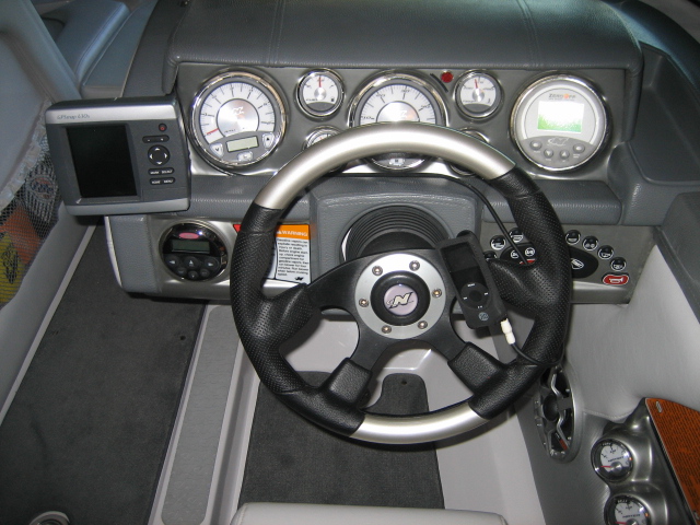

          I use a Garmin GPSMap unit on my boat with the addition of the depth finder/transducer. The mph is 100% accurate when comparing it to the ZeroOff mph, and the depth is always accurate too. I highly recommend this unit because of its preloaded detailed maps of the lakes. I am sometimes paranoid of running into islands and shallow water, and this unit shows everything in detail, water levels, islands, sat photos. Check it out

            That is a creative iPod mount approach. Have you ever had any issues with cord wrap when you make a quick hard turn?
