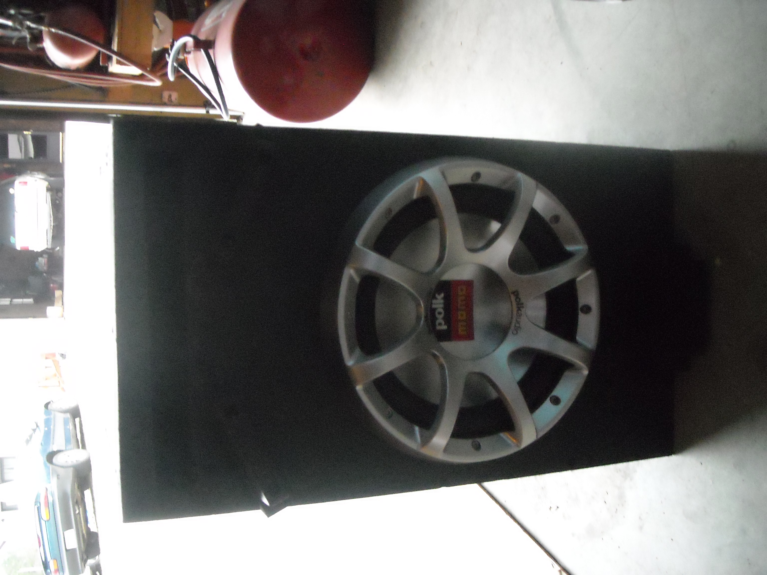

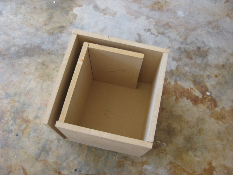

            This is the ported sub Box I made for my boat. Just finished it this week. Painted it with the spray on bedliner instead of carpet and will have it lifted up off the floor to keep moisture off of it just in case.
            2010 Super Air 230
            2008 Super Air 210

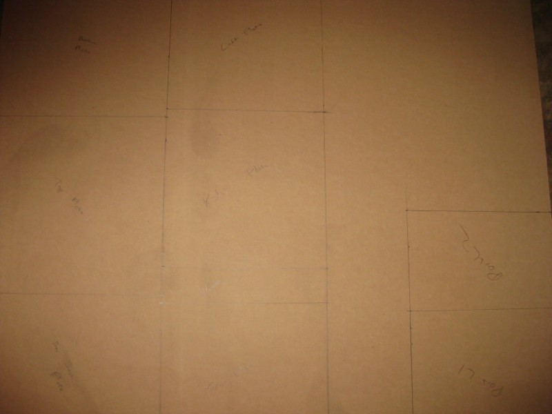

              I got the MDF for my ported box yesterday, holidays have been keeping me busy. I did have time to relocate my ipod jack to the drivers side, so that got crossed off the list at least.

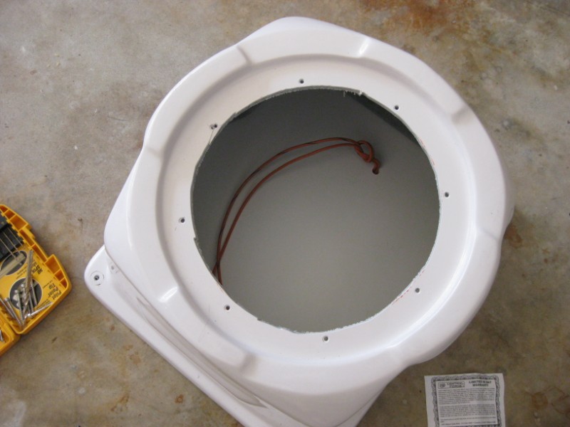

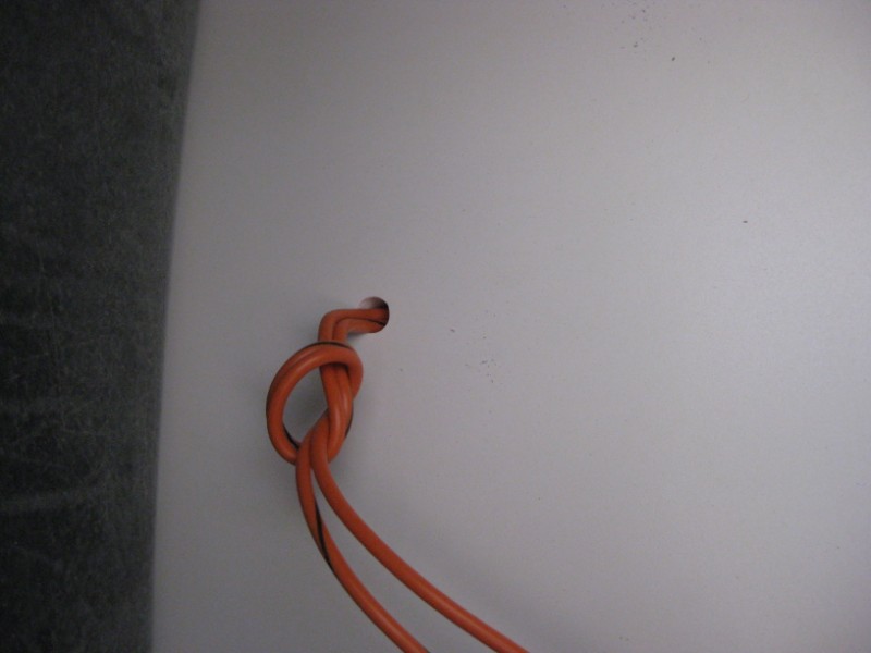

                #52
                Progress Report
                Old box out... no wonder why it leaks air??
                Doesn't look like there's been much effort at all to make it sealed. These guys could have at least drilled a smaller hole for the wires and put a dab of caulk on the thing.
                • andyray
                  • Jun 2008
                  • 44

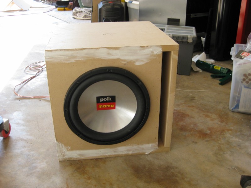

                  #53
                  Box building
                  Ahh... memories.... reminded me of being back in high school putting junky flea market subs in my buddies civic... only with better tools, better wood, better equipment...
                  Don't make fun of the obsessive use of caulk, I'm an amateur and it'll all be resin coated and carpeted in the end.
                  • andyray
                    • Jun 2008
                    • 44

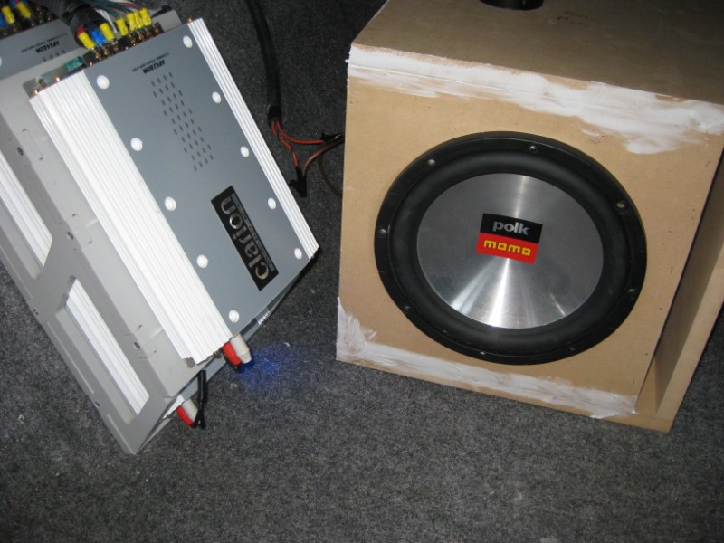

                    #54
                    Pre-carpet Testing
                    I'm blown away. My expectations were greatly exceeded. Big thanks to David from Earmark for making this recommendation.
                    After making 0 amplifier changes and investing less than $20 in materials, the sound is light years different. The SPL seems almost 2-3 times as much with the gain in the *exact* same place. I went from a sub that I could not even hear, to one that sounds like it wants to burst out of that compartment. Now I understand why people need to vent them! I'm also going to need some dynamat.
                    Frequency response is also greatly improved, I can hear/feel notes that the old enclosure couldn't reproduce.
                    All in all - I'm absolutely amazed. I would have never expected this much difference just in a box. If you have the factory sub setup, go do this now! It's low hanging fruit! I'm going to try to post a video on youtube of it playing to give some context for how big of a difference it makes.
                    I think I'm pleased with the results as it stands, but I'm hooked now, I'm going to keep going.
                    Next steps - finish + carpet box, then vent. After that, amp #3.
                    Thanks!

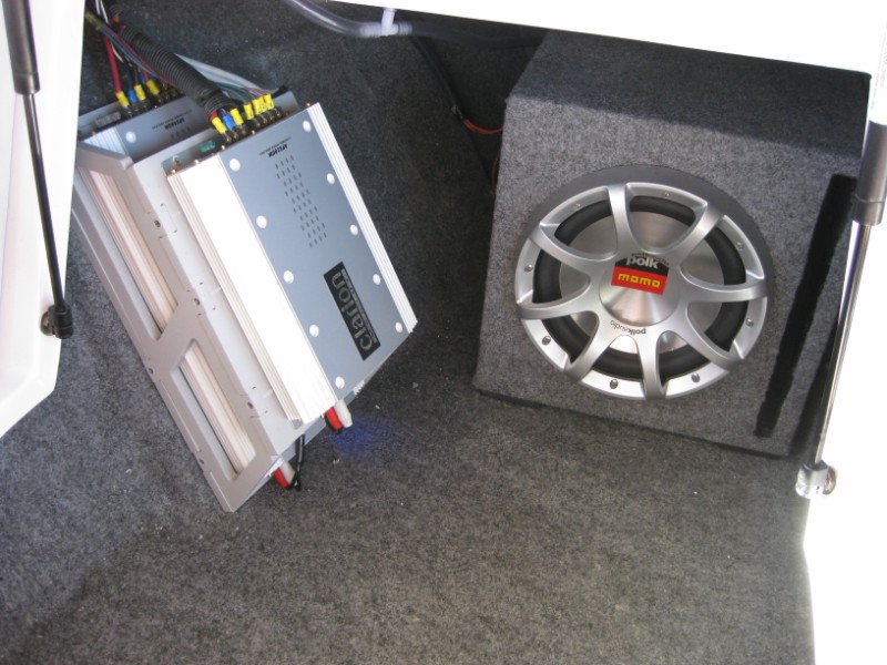

                                #60
                                more finished
                                Here are some pics of the finished box....
