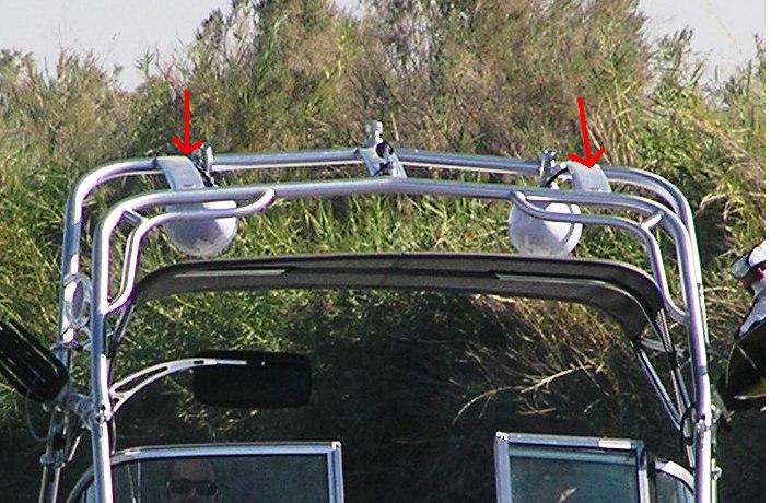

        Here you go.
        http://www.planetnautique.com/index....amp;highlight=
        Brandon
        2006 SAN 210

            bp22 i guess you have to drill the 1 1/4 hole to feed the wire back through the cross member or is it possible to do it with out the hole
              thanks
              It may be possible, but I couldn't do it. My main crossbar on the front of the tower was pre-drilled, but I couldn't get my fishline through it becasue of the sharp turn. I cut the holes and it made it easier and accessable. I went with a 1 1/4 hole, but you could definitely go smaller. I got the stainless caps at Home Depot and siliconed them in. When the boat is on the water you don't really even notice them.
              Good Luck.
              Brandon
              2006 SAN 210

                Brandon,
                Very nice job on your install. On your version of the FCT you really do need to carry those wires towards the back to hide them.
                Interesting, so CC pre-drills the round tube where it intersects with the crossbars. I was pleasantly surprised when I found the port side leg and foot were pre-drilled, made everything much easier.

                  Originally posted by Quinner
                  Brandon,
                  Thank you. I have seen two 2006 SANs (both Sig Editions) that had the tube pre-drilled. Definitely made life easier.
