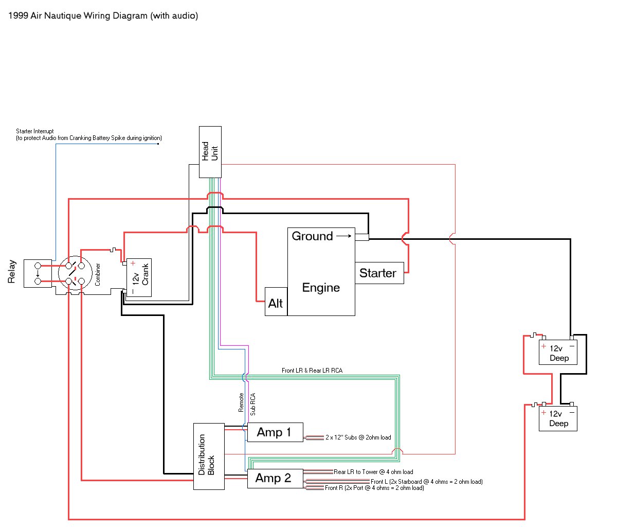

            Okay, Jaybird... 1 last one for you. I think I might finally understand enough to do this right (and minimize the runs). I have simplified the wiring diagram quite a bit to what I think is the minimum number of wires possible. The only thing that I question is whether I am okay with only the 1 power run from the Deep Cycle batteries. Can power flow in both directions on this 1 line? By that I mean, can power flow from the battery to the amp through this line while power also flows through the alternator back to the battery? As a practical matter, I don't think power would need to flow both directions simultaneously. If the alternator has enough juice to power the starting battery and the amps, no deep cycle power should be needed. The deep cycles would only be needed to power the amps when the engine is off, in which case the alternator would not be powering anything. But maybe I am missing something. These lines are going to be 1/0 AWG, and for marine tinned wire, that's like almost $5 per foot, so the fewer of these runs... the better. I think this might be your setup.

              Looks good, just be sure the wire to your starter is larger than 1/0. You will need 2/0 to the starter and also from the starter battery to the battery switch.
              I hope I didn’t confuse you with my photos. While I did use the same kit I do not utilize it the same as the Blue Sea schematic. My switch does not disconnect the starter battery from the starter. I changed my layout to eliminate a long run with 2/0. The only down side of what I did is the starter battery remains connected when the switch is off. It does kill power form my secondary battery to the amps but thats all. The reason is I have my starter battery in the back of the boat and my secondary battery in the front. I only ran #2 wire to carry 100 amps between my primary and secondary battery, which takes care of the alternator current.
              DC current never flows in two directions, not sure what you are asking there. The combiner relay or charging relay will close to send current to the amps and deep cycle battery’s when a charge is available. That’s a bit difficult to explain. If your amps are pulling more than the alternator can put out then the charging relay will open and only charge the starter battery. When voltage on that side reaches a threshold preset in the charging relay it will close and charge the deep cycle battery’s. If the amps are drawing current form the alternator and the starting battery the starter battery will drop below the threshold and the relay will open to prevent excess draw on the starter battery.
              I hope that makes some sense. In short power for you amps will come from the highest potential. It is a dynamic situation and constantly changing depending on power required and power available.
