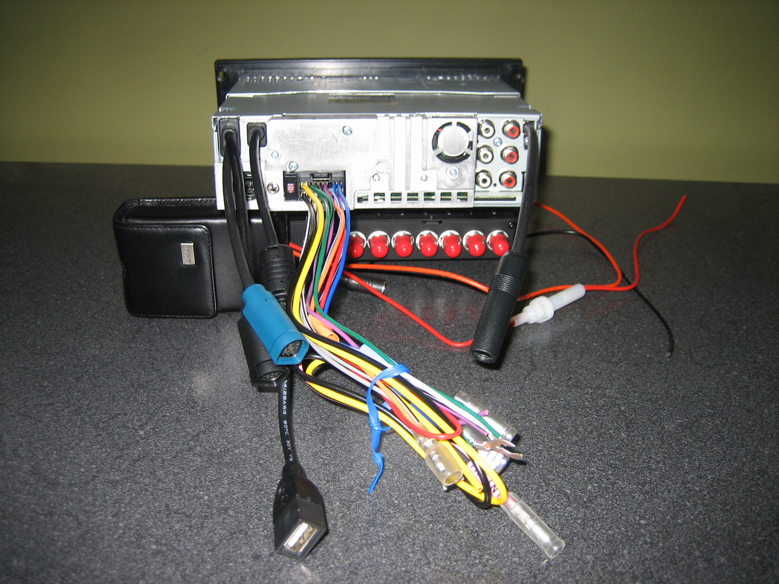

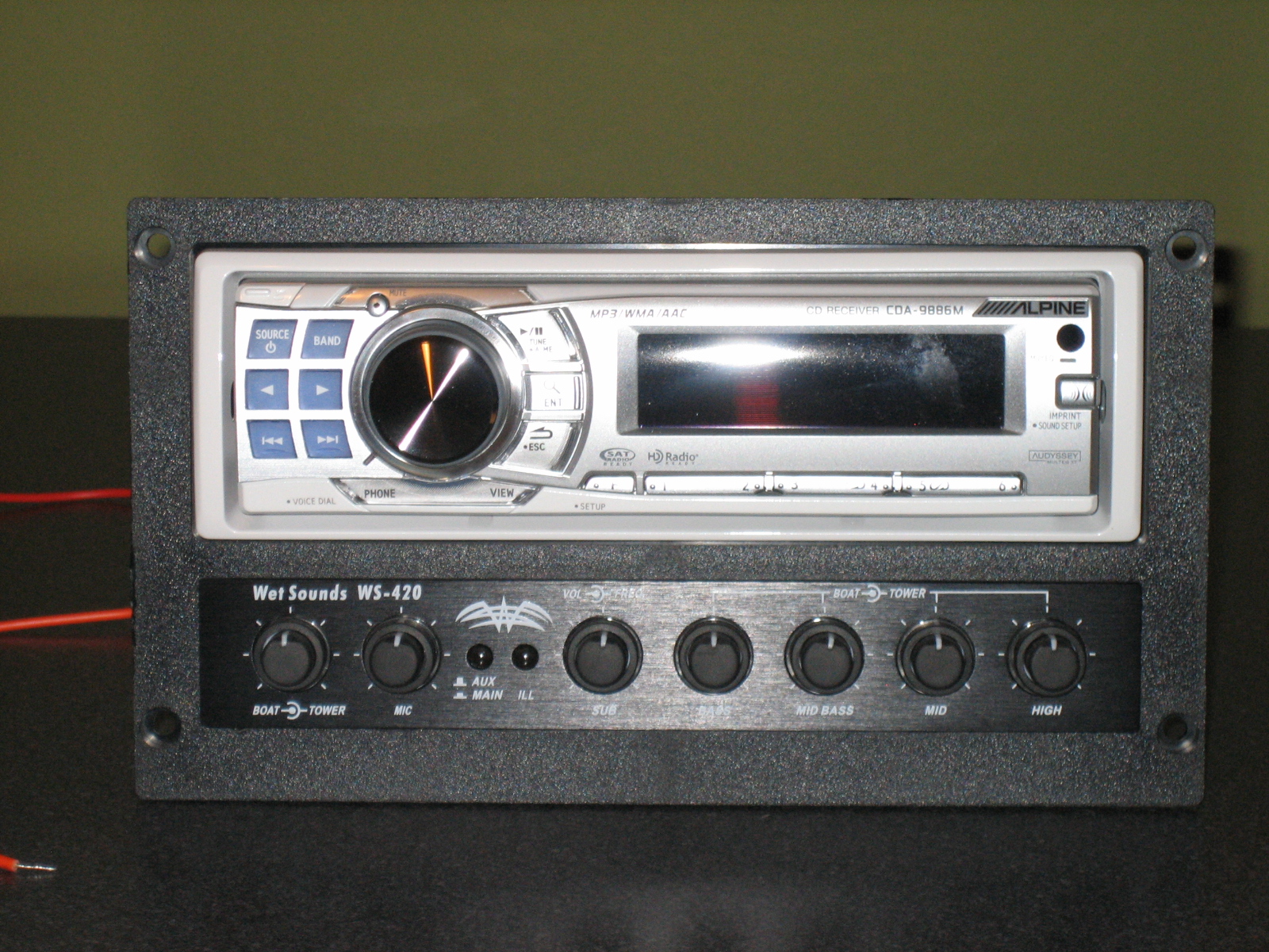

        I just got mine in today and looks pretty solid. Definitely switching out the white bracket though.....thought some of you guys would like to see what it looks like

          Question: Why do you have the Wetsounds 420 AND the Alpine? I ask more for my own benefit, as I am looking to upgrade my system and you can control your Wetsounds Pro485s and inboard speakers all with the Alpine.
          • SuperSquirt
            • Apr 2008
            • 534
            • Tennessee
            • 2008 SANTE 210
            Depending on your future system setup, the Alpine is great if you have a subwoofer and no tower speakers. But if you have both, the 420 will allow you to control volume levels separately (tower vs. inboat). You can crank one set and turn the other off and vice versa. It also has sub controls and a microphone. The Alpine receiver does have 3 pre-amps, but the fader/balance can't do what the 420 does.
            Overall, I highly recommend Alpine for superior sound quality since it has a 24-bit DAC and 4-volt preamps. I can tell a huge difference versus the old Clarion I had before. Not to mention the wired remote thats coming out later this year.

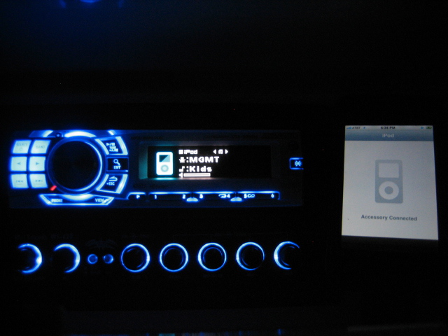

                The iPhone officially works with the Alpine radio. You can't surf through any menus because it locks up, but you can access all your music folders and what not. Here is a pic of what it looks like...

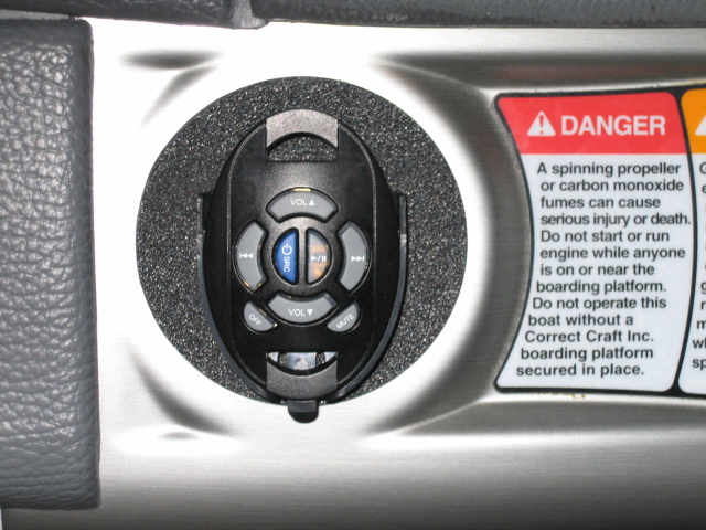

                    With this Unit can you still utilize the Clarion remote next to the driver steering wheel?
