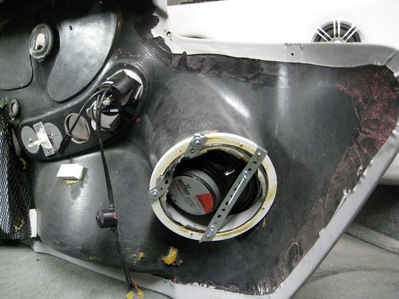

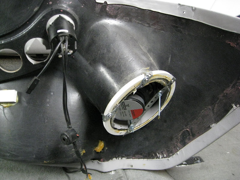

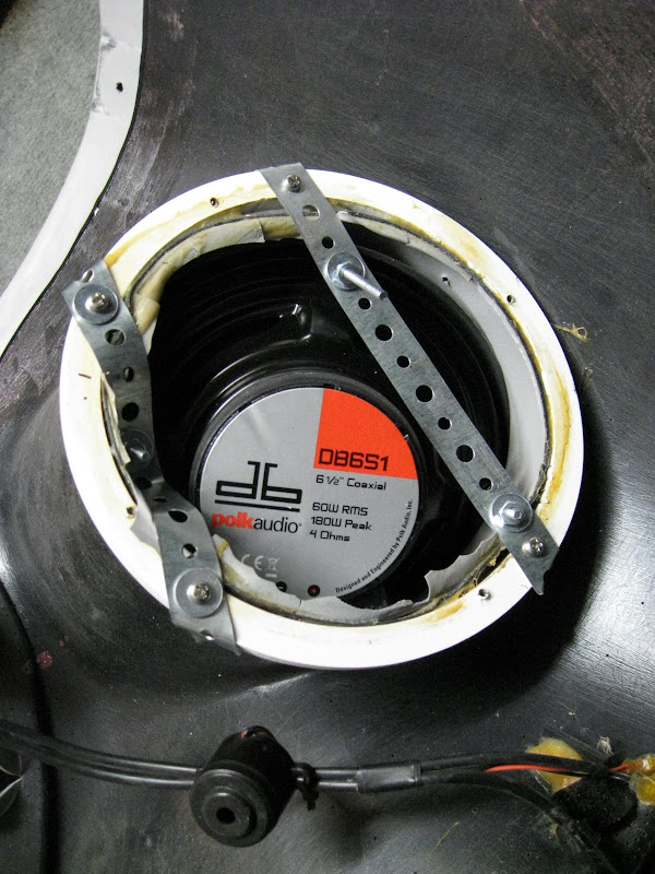

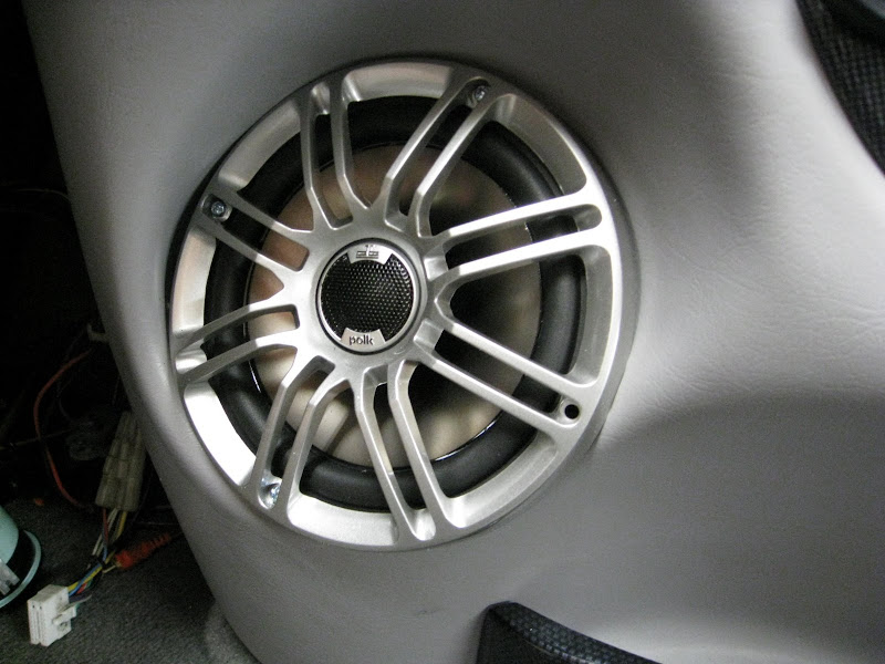

          Figured it out. Super Easy install.
          Ill take a picture of the back later today but we ended up buying 3 inch long screws and some metal pipe straps. Screwed two peices of the metal strap to the back of the speaker mount and then put the long screws through the holes on the straps and cranked them down tight.

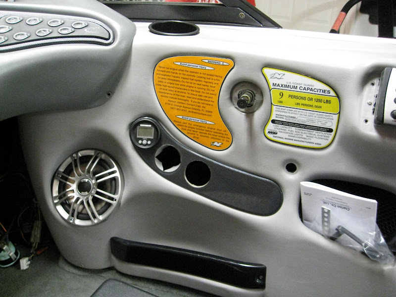

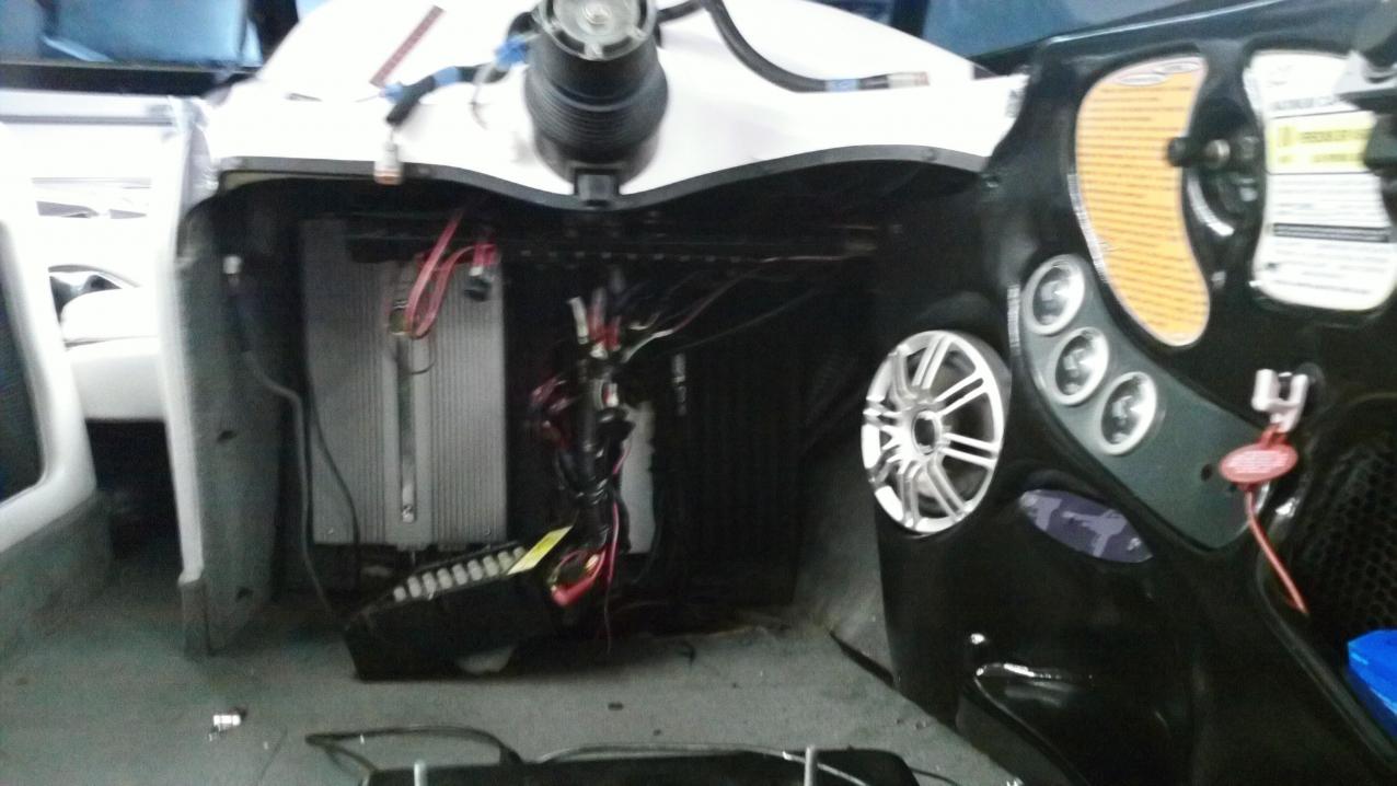

            I see that you've disconnected your clock, etc. in the side panel. Did you have to do that to get the panel out? Do you have to remove the panel completely to replace the Head unit? Looks a bit different than mine. vr6mole.....thanks for the picture.

              Removing the side panel is pretty much required to do the speaker install. Takes about 15-20 minutes to get everything off. You only need to take the screws off the actual dash itself and lift it up to get the side panel out. We left everything plugged in on the actual dash piece.
              To remove the gauges on the side I would recommend to take a picture before you unplug anything. Then remove wring from one gauge, remove gauge, and then plug it back into wiring on the other side of the panel. Do this when you reinstall everything and you shouldn't have any issues with the wiring.
              Throttle can be removed with an allen wrench from the bottom.

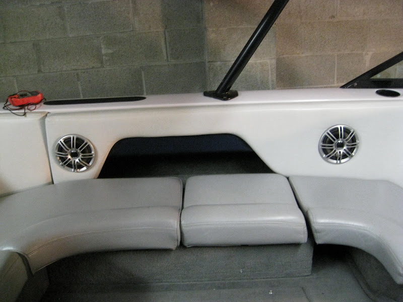

                Here are some pics how vr6mole and i did our install, like he said it was a lot easier than we thought it was going to be. The speaker grill hangs a little on the bottom but barely noticeable.

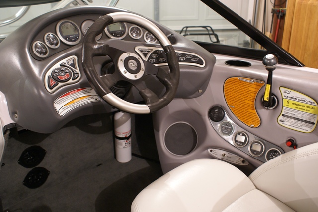

                  OK, I'm reviving this thread because I've actually put the wheels in motion and have three of my four speakers now front-mounted. Of course, the lone wolf is the one in the driver panel. I've completely removed the panel so am ready to go, partly in order to put in a new voltage gauge but I'm also going to put in my last Polk. I can't seem to get it to fit like liquid-diet's. Anyone else tackled this or can offer up a different solution. The Grant threads are no longer available here nor on wakeworld.

                        i got mine to fit in nicely and even put LED rings behind all my speakers. while the driver panel was the trickiest, do exactly like the above and use metal strapping and 4" threaded bolts, cinch it all down with a wing nut. should work like a champ
