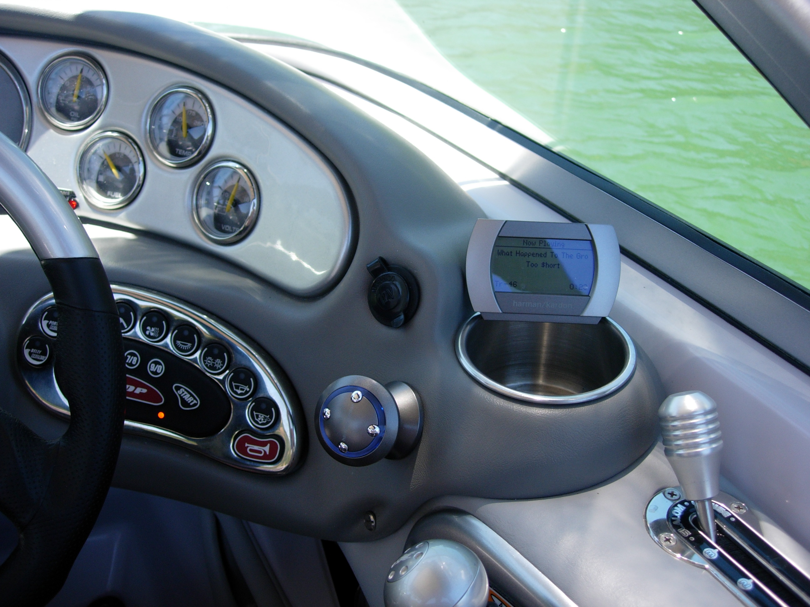

                  I installed the Harmon Kardon drive play
                  • 230konrad
                    • 45
                    • Smith Mountain Lake, VA
                    A clean and inexpensive solution that keeps the ipod (now the iphone) charged and at your control.
                    iPod Hookup on my 08 230 - Total Driver Control
                    http://www.planetnautique.com/index....amp;highlight=
                    Cheers!
