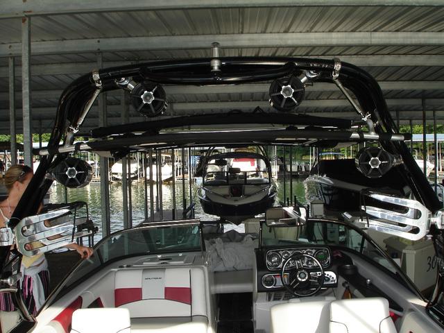

    Right, but that is the original FCT tower, not the new curved FCT3. The boards definitely sit farther back. They already kind of rub against the stock cans.
    • NautiqueJeff
      A d m i n i s t r a t o r
      • Mar 2002
      • 16517
      • Lake Norman
      • Mooresville, NC
      • 2025 SAN G23 PNE 1985 Sea Nautique 1980 Twin-Engine Fish Nautique
      Ah... Different tower could certainly make a difference.
