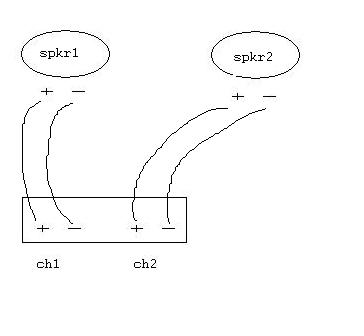

                              Few more questions about configuration, I am not up on all the audio lingo but I think bridged means you combine two channels into a single channel which doubles the power.
                              With my current system I have it wired like the attached picture.
                              1. With my current 2ch amp and 2 tower speakers is there a better way to wire it? If so what would it look like?
                              2. If I get a 2nd 2ch amp and still have the same two speakers how would the wiring look? Would I "bridge" each 2ch amp to 1ch, then have each amp power 1 spkr?
                              -Jon
