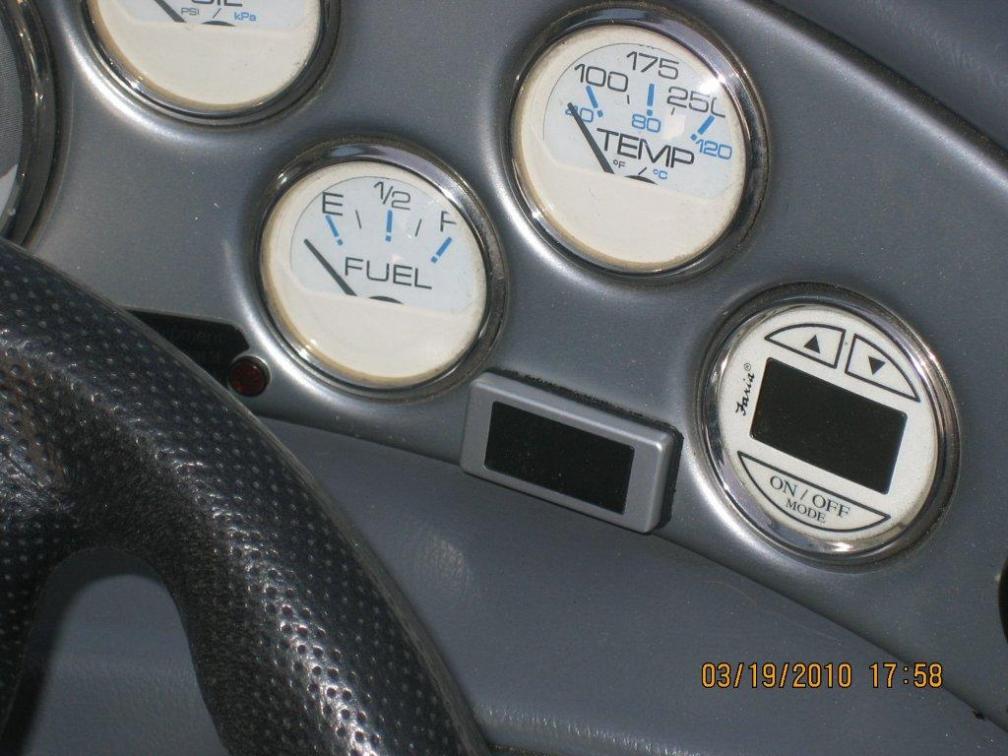

        what was your battery voltage? My guess is that it was below 11.5 causing your issues. You are running blind if you do not have a good digital voltage gauge for your stereo battery bank. I look at this gauge more than any other gauge on my boat.
        The square box is my digital voltmeter for my stereo dedicated battery bank.
