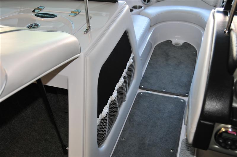

            Another option is to vent the passenger side compartment so air can flow out from the space in which the sub sits...similar idea to moving the sub to the starboard side so it is in the open. It's a night/day difference and, in my opinion, sounded pretty good when I had it in my boat.

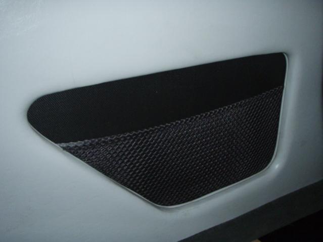

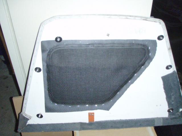

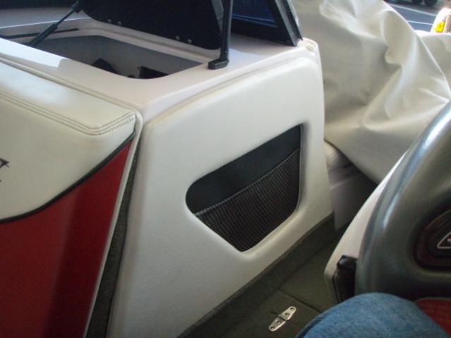

                Here are some pics of how I vented my locker. It was easy and looks factory with the screen cover.

                  Hey Seth--I came up with a similar solution. I didn't take pictures like you so I can't show the intermediate steps. Basically, in the same area I drilled six 5" holes (maybe 6"...can't remember off the top of my head) instead of cutting out the entire center of the panel. I then lined the opening in the vinyl with speaker cloth backed by foam (to give it a little body so I wouldn't see movement in the speaker cloth). As with yours, it's an inexpensive solution that looks like it might have come from the factory.
                  David--yeah, I agree the best solution is upgrading the sub (and the amp) in addition to venting. But, with a little labor and very little expense, I think the stock sub sounds pretty good. Just depends on how much money you want to spend since you should really be venting the area under the observer seat no matter what sub is placed there. I ended up with a WS XXX and Syn 1...but, of course, the cost was significantly greater than sticking with the stock set up.
