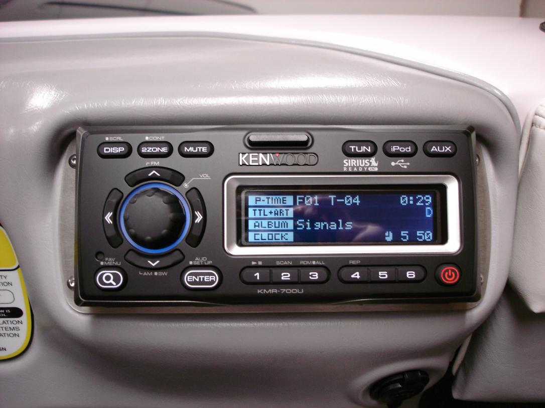

    I had that stock Clarion in mine. It was just too old tech for me so I replaced it with a Kenwood that you can put your ipod inside.Click image for larger version
