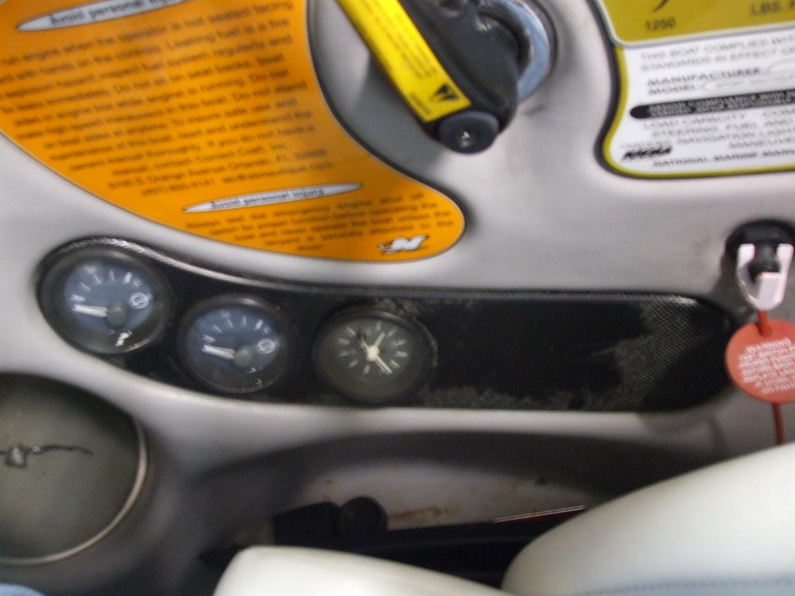

          mounted from behind like the factory one was. you have to remove the kick panel to mount it. used original mesh grille on front, removed the cloth and added a custom touch.

            this is the best one of the original i can find at the moment. the orinal speaker was screwed in from the back side into the "pvc" piece. i mounted the new one the same way.

              I will take a picture of my original cloth install when I get to the boat soon, but the AIR pic is what I was talking about with a custom flare, maybe even covering with a carbon fiber look
