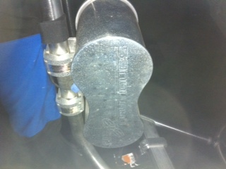

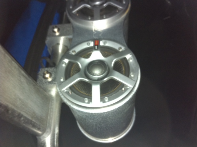

      I believe they are the stock cans that came from the factory (I'm the second owner). i've attached some pics - sorry that the orientation is off.

        I'm on a similar quest - upgrade the audio without a wholesale replacement of the whole mess. I emailed with David at Earmark and did quite a bit of research. It seems that replacing the stock drivers in the cans with HLCD's and giving them a dedicated amp will give you a great deal of bang for your buck.
        If you want to improve the sound in the boat, redeploy the remaining factory amps to power the boat speakers and the sub. Then put the sub into a proper enclosure. All in I'd think you'd be around $1500-$1800 in parts.

            I went with 2 pair of PRO696's to fit into my 4 factory 6x9 cans, replacing the stock drivers. The power-hungry tower will now be fed with a Syn2 amp. I will use the 280 bridged to power the sub, and the 480 to power the boat. This gets the boat speakers off the headunit, which is always a good thing. I'm expecting great things. My whole package was only a couple hundred over your budget, but if you only need PRO60's, you might be closer to your budget. You could also mod the locker door yourself and be in budget I suspect.
