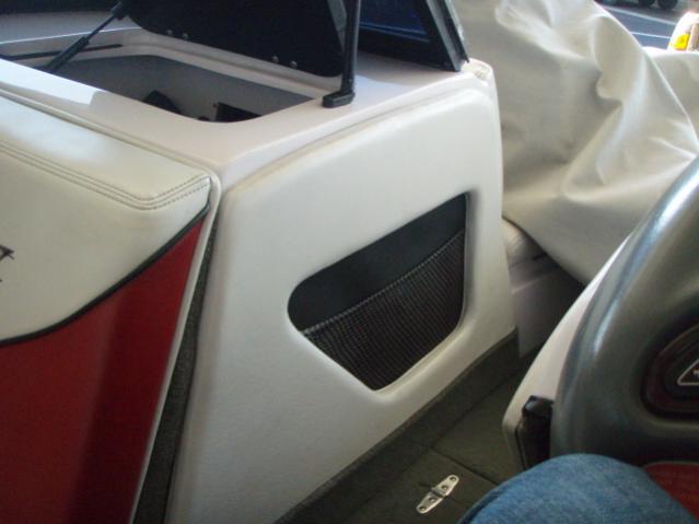

    Mine has a big port under the observer seat overhang. Does a nice job and you don't see it much.

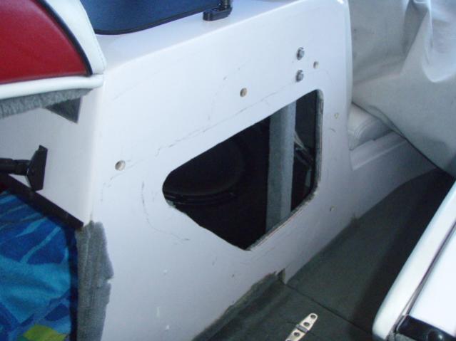

        I cut this hole out to match the hole in the pad. Stapled on some 99% screen from Home Depot. It looks factory.

          I'm going to get the boat tomorrow and I'll post a pic. And yes, where your bottom arrow is. Basically it's cut in almost an oval shale about 12" long and 3 or 4" tall, with some carpeted molding around it to make it look nice. the vent itself seems to be just flat, perforated aluminum.

            seth that looks great, good job! I see your sub is firing upwards.

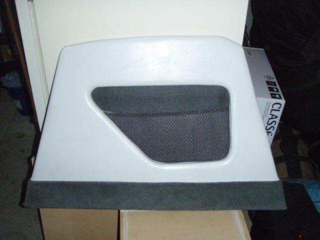

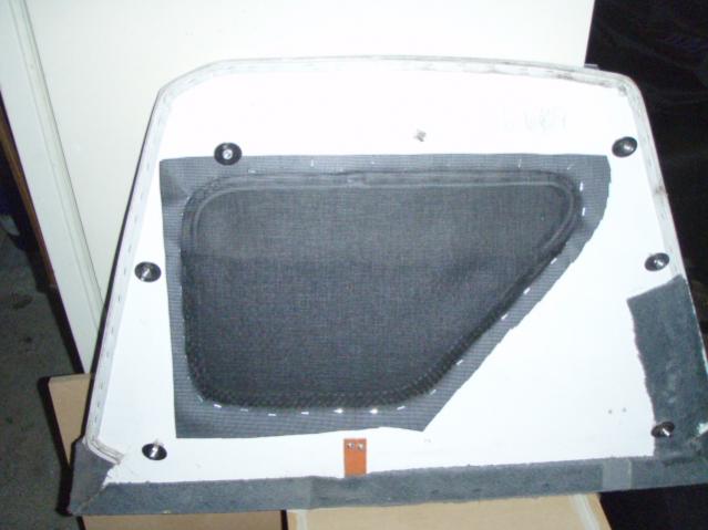

              Do both. I had this added and its a whole new system. I know not your year but same concept. The smaller rear facing vent may not be enough.
              I made this and will add it soon.

                  The vent I made was really easy as well, and made a big difference! I think it was loosening 5 nuts on the pad and the 4 screws on that structural bar and a jig saw to cut it out. Just trace the opening with a pencil before you take it off.

                        Yes I did. It looks fairly stock too without much cutting.
