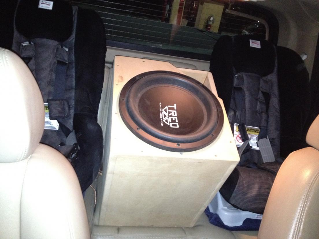

                    My kids love this setup...

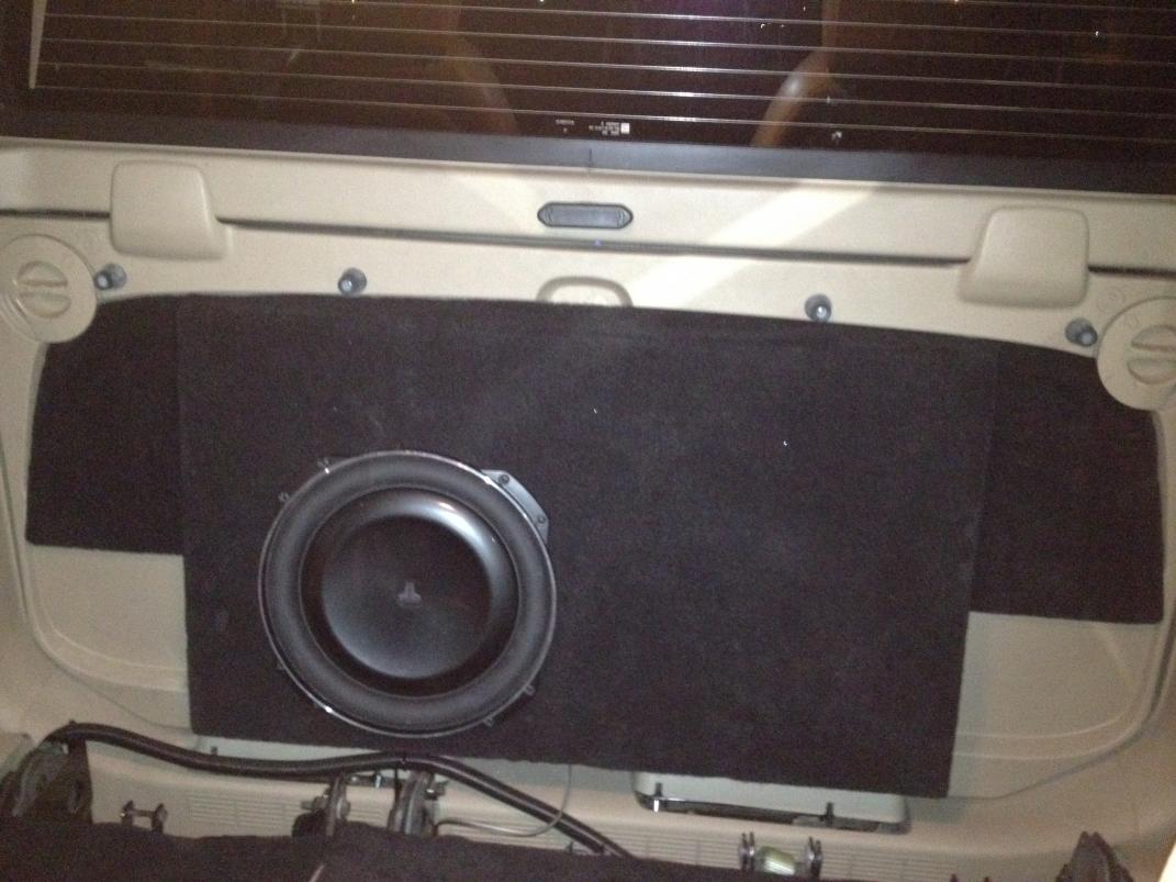

                      but seriously... I had the Treo 12" sub lying around so I threw it in this box designed for a wetsounds XXX. It does pretty well and is too much for my tastes in a truck. Interestingly, I messed around with placements in the truck for a week and was amazed by the difference in performance levels just moving the thing around. Shooting forward it was completely ineffective, shooting up it was OK, shooting from rear passenger footwell toward rear driver side it was just OK, shooting from rear passenger footwell at the door it slammed (like 3x any other orientation). Here is the real sub I run when I am not messing around. Powered off a JL 500/1V2 driven high level from the factory Bose sub speaker wires (factory sub cut out of system). This sub is a JL13TW5 needed for the shallow mount and low volume behind the rear seats in front of the midgate in my Avalanche. The ported 10 is probably going to produce a similar volume level and I would say that is probably enough.
