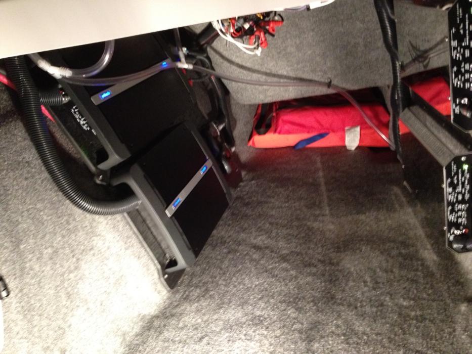

            Attached is image of AMP configuration. Dave is right with the wiring, I changed out the gauge and noticed monumental difference.

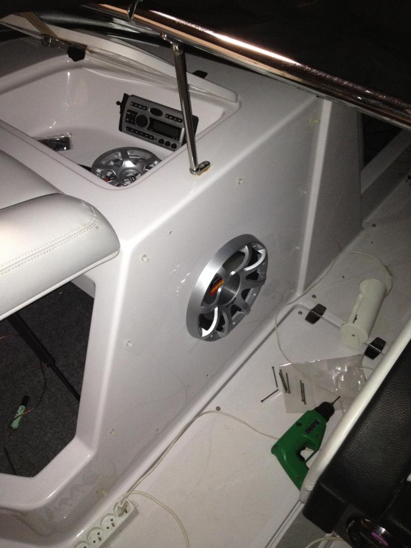

                      Thanks for all the info. I'm considering relocating the sub under the driver's helm and installing a new amp for the sub. I want the sub out of the locker for two reasons. One being sound quality and the second being room. I'll be pulling the driver's kick plate soon and taking measurements. I'll keep you posted on the outcome.

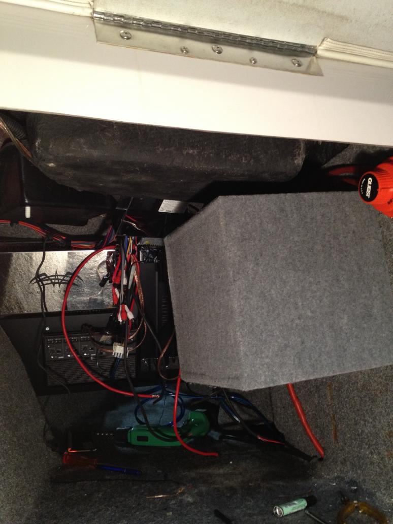

                              The factory sub is not at all a bad one if you built a correct small box like this:
