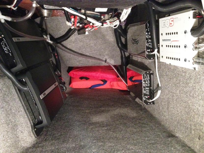

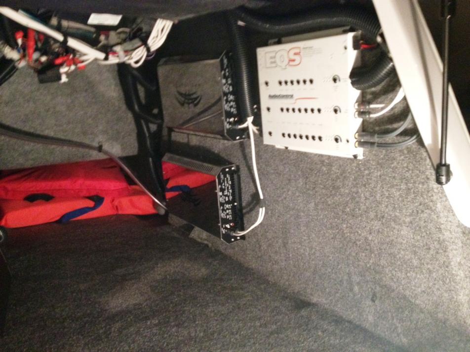

I have two blue top Optima batteries (D31M)....but these are meant for long drain and not high demand power that the amps put on them. I think my winter project for the boat will be adding an XS Power battery(ies) with a high output alternator (and fabricating a surf gate).
So far I haven't had an issue with power, but they definitely need to be charged after every use. I added additional pictures after having added an AudioControl EQS (EQ and line driver....the line driver made world's of difference on the sub and all the speakers - clarity and volume) **still needs to be cleaned up...
