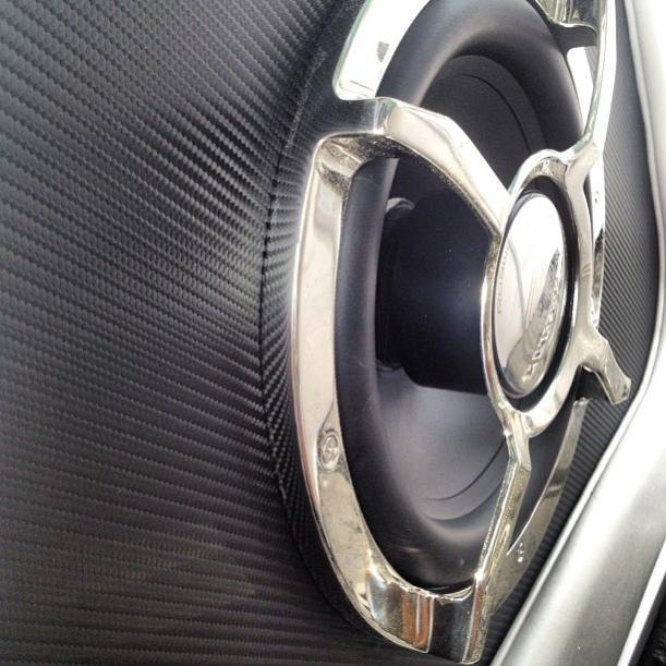

                      Sealed box in the walkthrough. Could not be happier! Total game changer in my boat stereo!
                      [URL="http://www.ridebutter.com"]http://www.ridebutter.com[/URL]

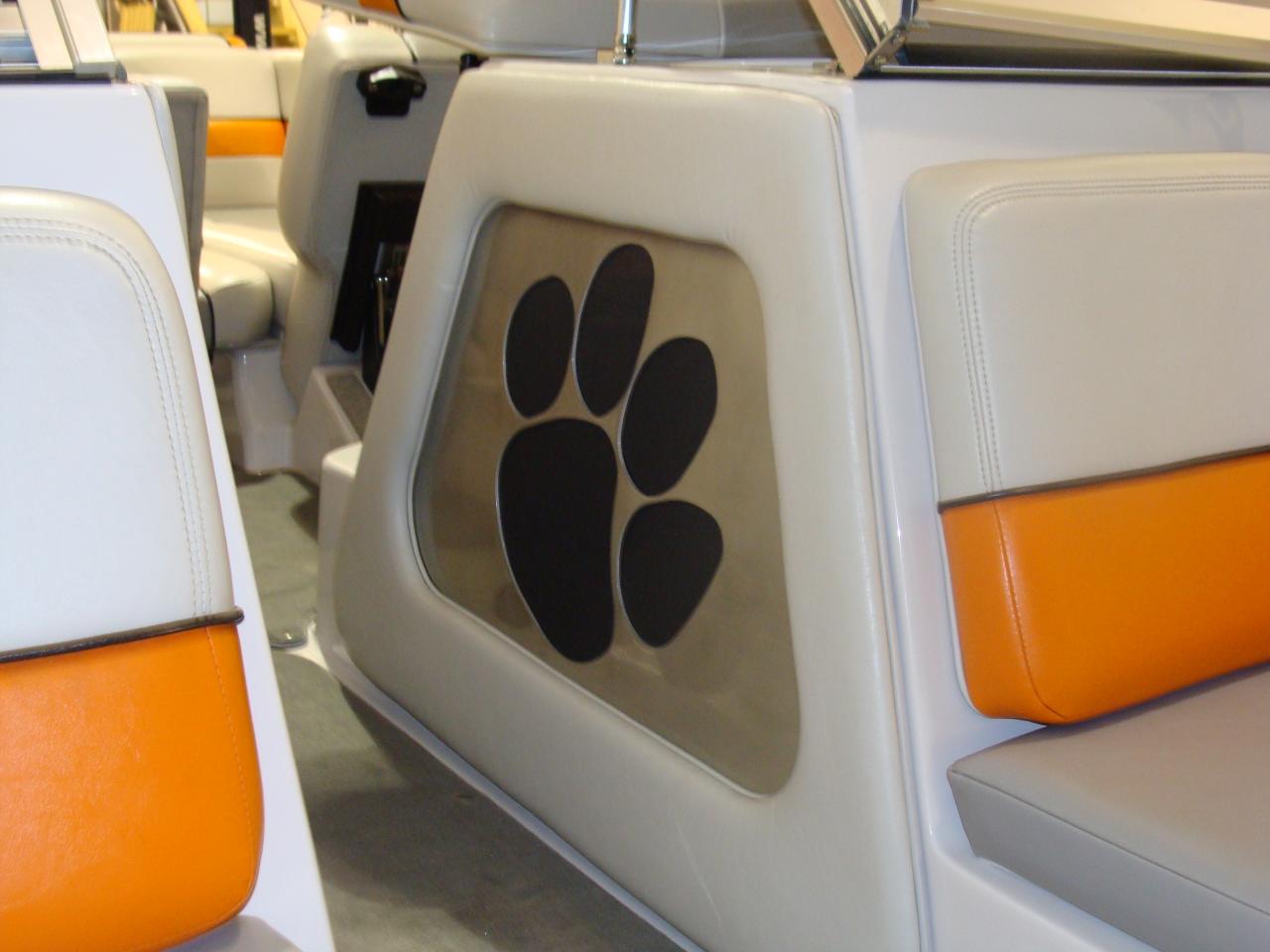

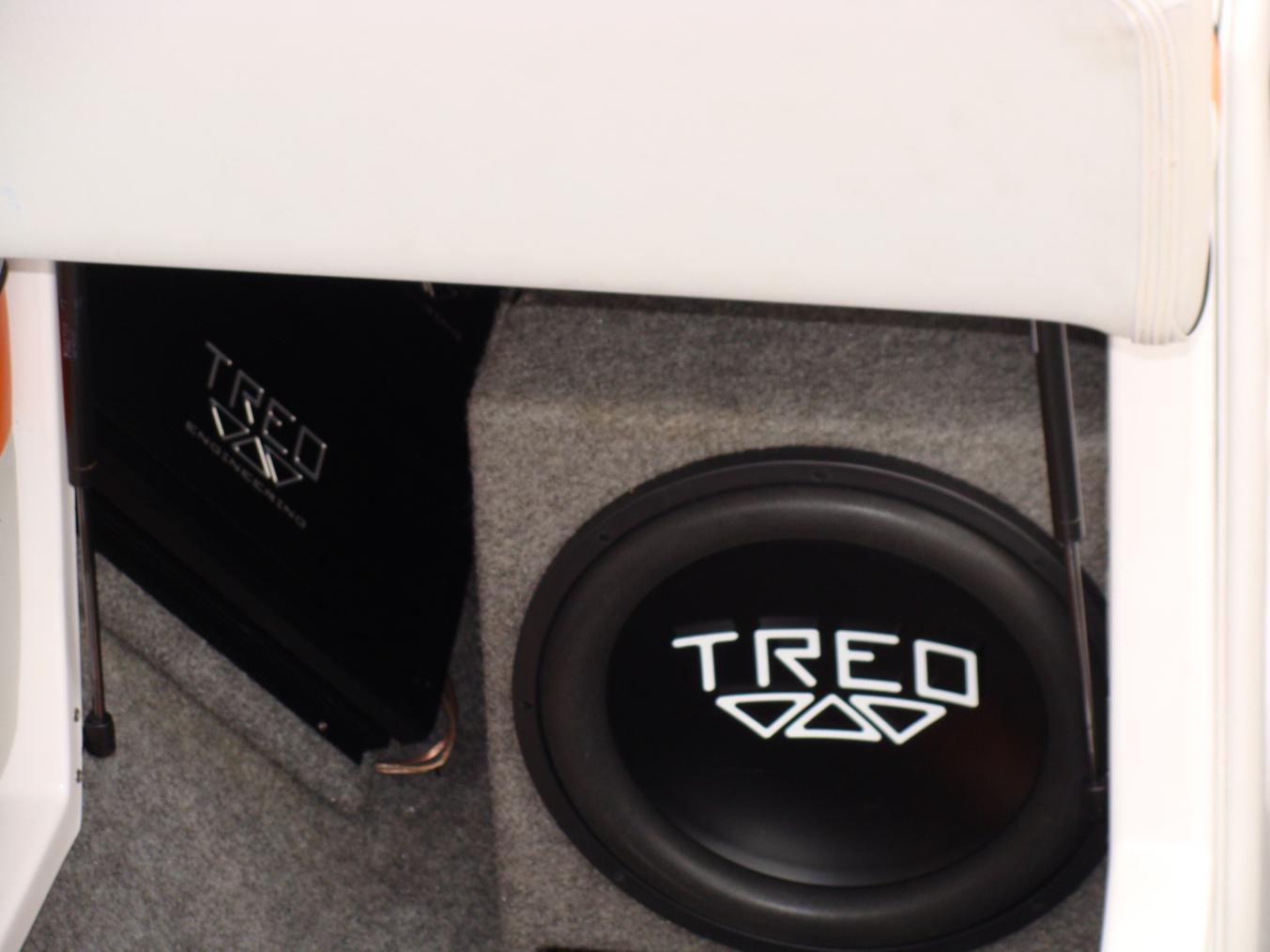

                            Approx 3 cubic ft ported box housing a 15 and as big of a vent as I could put in the walk-through wall. Couldn't be happier.
