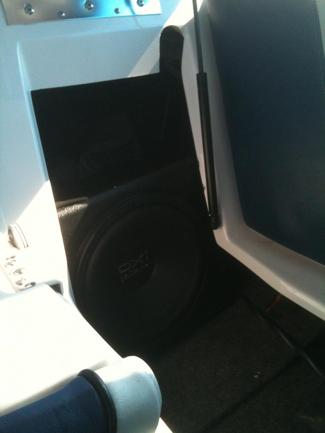

    Sub (sealed box) in the back in front of 1,100 lb sac. Sounds pretty good. Another approx 600 lbs of water under the loveseat. No sac's out while surfing. Great wake. Priceless.

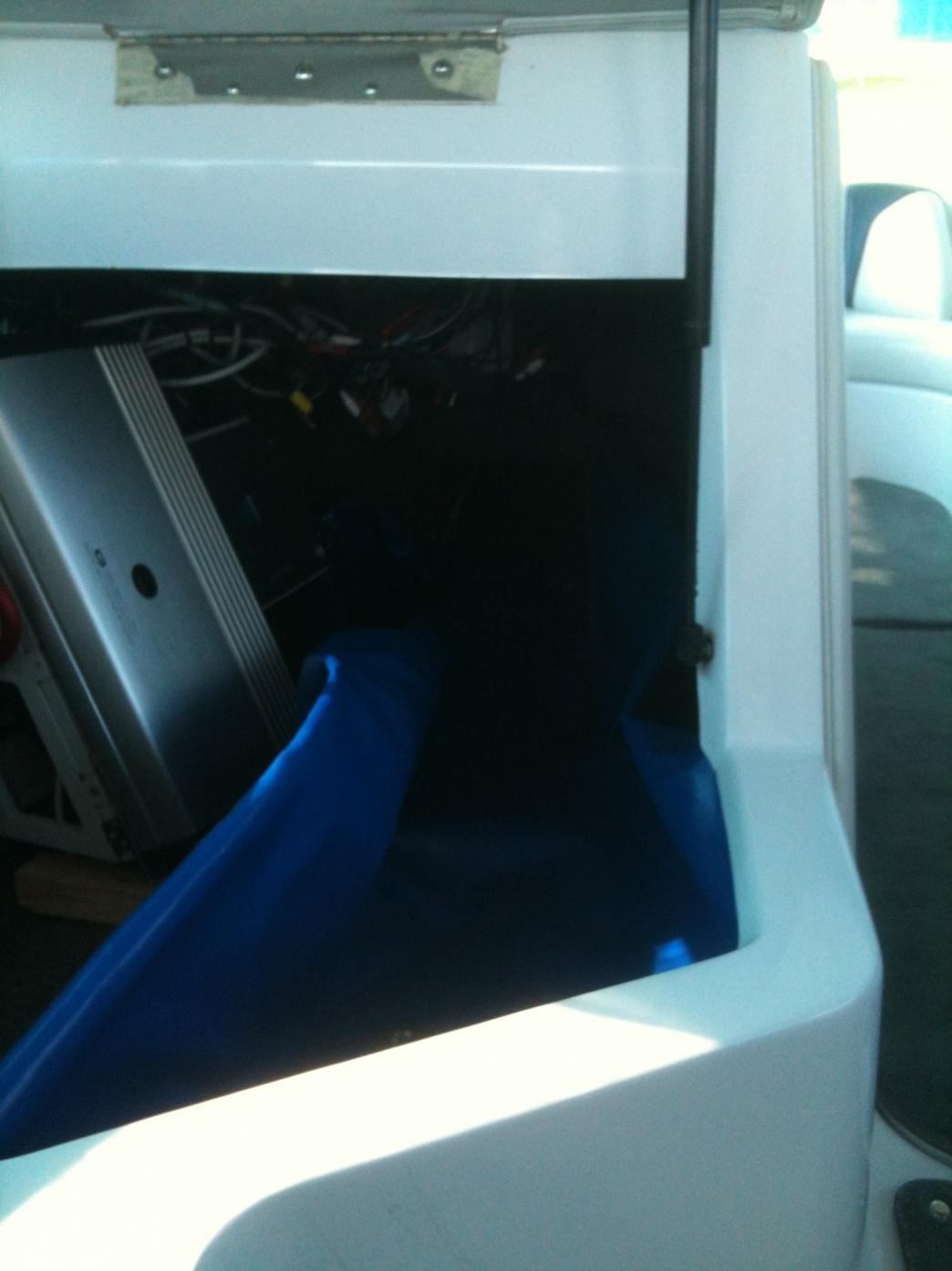

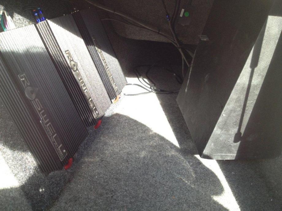

      I build a sealed box and sandwiched the wall between the sub and the box. Just make sure you have an airtight seal between the layers. The sub is the Roswell 1211 DVC and I powered it with the Roswell RMA500.1 Mono Amp. All season of slamming bass, and no issues!Click image for larger version
