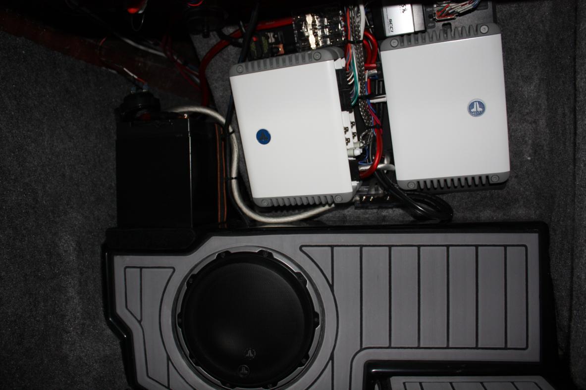

            I can post pictures of my setup when I get home. I put in 3 JL HD amps and a kinetic battery in the same mounting location of the stock amps.
                  As promised, this is my current G23 stereo setup. That is 3 amps (2xJL600/4 MHD, 1xJL750/1MHD), the sub is a JL 10W6 and there is a kinetic battery there to handle the loads. I also installed the clarion EQ on the side by the trash can for adjustments and to boost the inputs to 4V preouts.
                  The speakers I am running in the boat are all Focal 165KRC which sound amazing. Still using the stock roswell tower speakers which are bridged to one of the 4-channel amp outputs and they sound really good actually, pretty clear behind the boat.
                  I hope this helps your decision.
