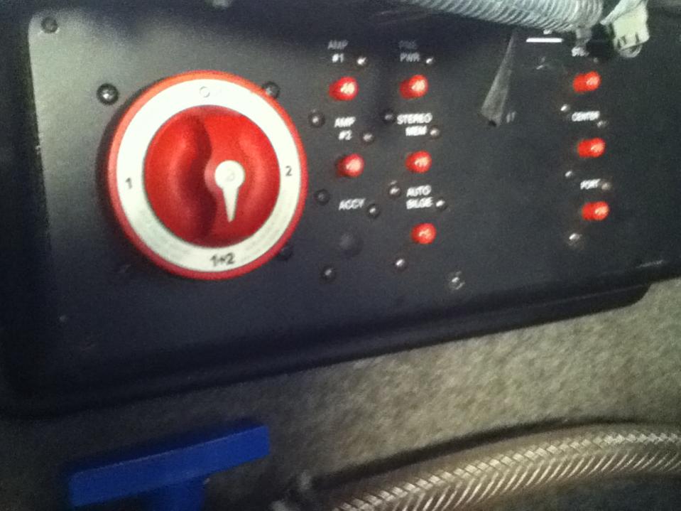

              Sorry the picture isn't great but I think you still get the idea. It is the OEM switch with Off, 1, 2, 1+2 settings.

                Originally posted by perry386 View Post
                [ATTACH=CONFIG]22796[/ATTACH]
                That looks like a conventional Blue Sea dual battery switch.

                  Awesome, that helps. This may not solve the battery drain just yet, but fallowing the B+ battery cables from both batteries to where they end may help solve the mystery as to why the switch seems to not be part of the loop.
                  With a traditional dual battery switch like you have, the batteries B+ cables should go to the "1" post and the "2" post on the back of the switch. Connected to the each B+ post of the batteries should be absolutely nothing but that cable going to the switch and the auto bilge B+ on at least one of the batteries. ALL boat loads: engine, helm, stereo/amps, etc, etc, should connect to the "C" post of the switch. This will have the switch as an intergral part of the system, as well as isolate all loads from the batteries when the switch is off. I would start by physically tracing cables.

                    Ok, so the B+ from all of my stereo and accessories should be connected to the "C" post of the switch? If this is the case then do I just put the ground directly on the battery?
                    Also, It's not just that the switch doesn't shut off my stereo and stuff. It doesn't work AT ALL. I can start and run my boat and stereo like normal while the switch is in the "off" position.

                      Yes, all the stereo and ACC B+ leads as well as all boat B+ leads, except the auto bilge B+, connect to the "C" post of the switch. Sounds like most if not all your loads are connected to either 1 or 2 posts of the switch, which is directly to the batteries. Pull the 4 screws that hold the plastic switch/breaker box to the wall and tilt it down and see.
