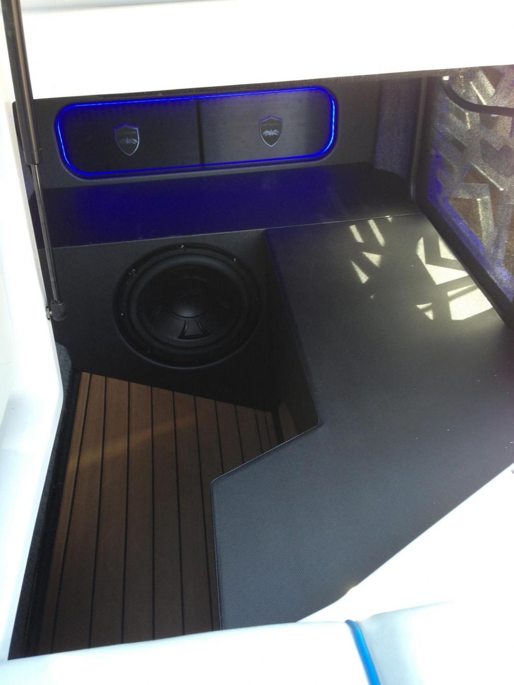

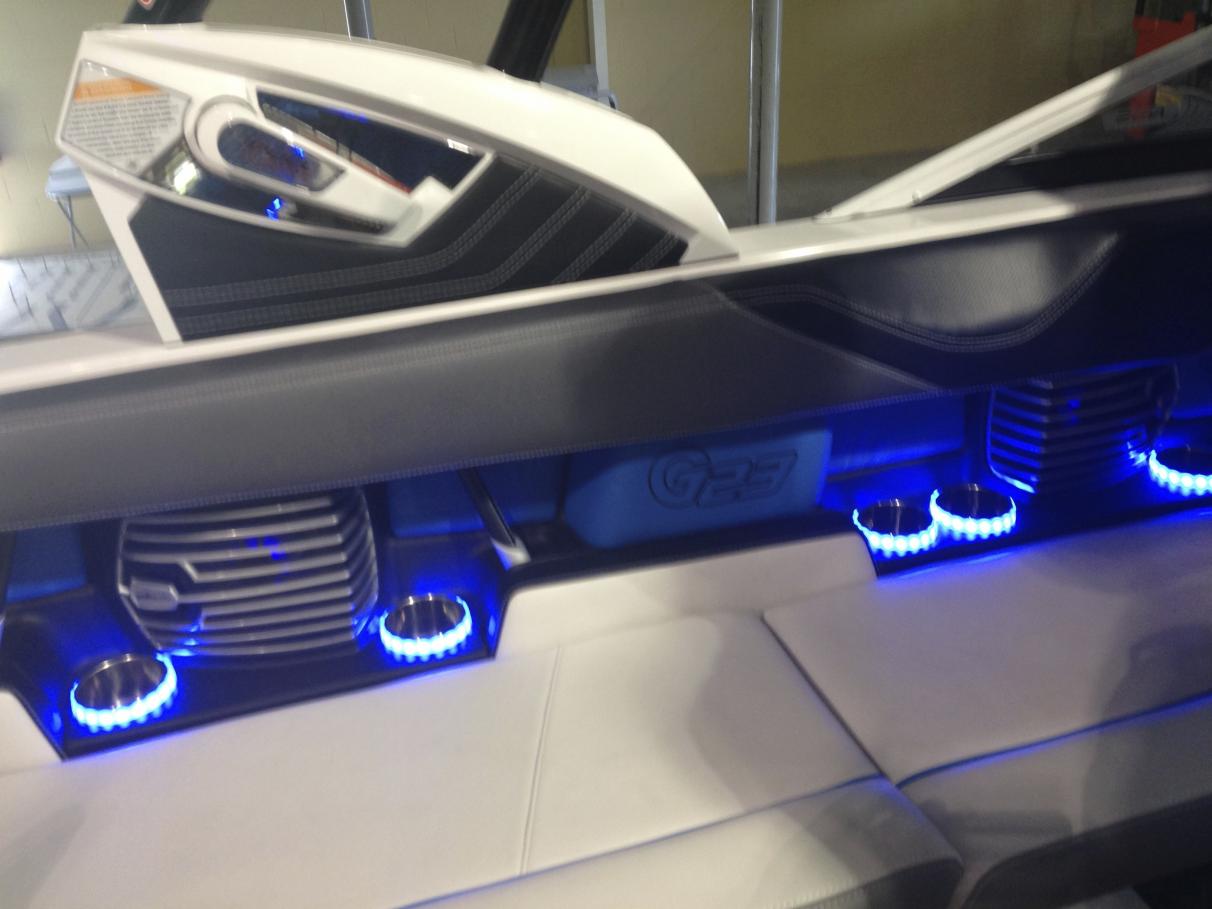

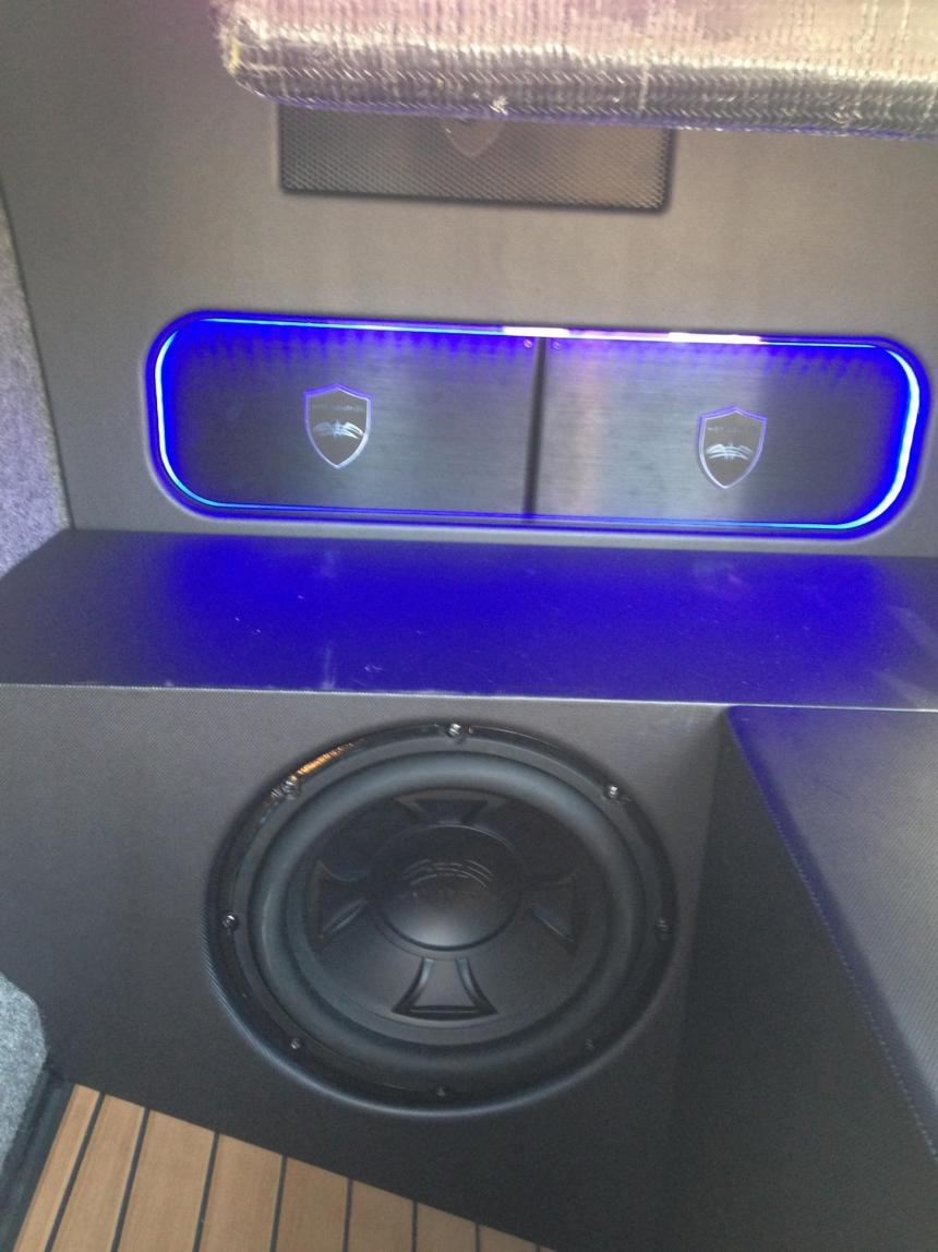

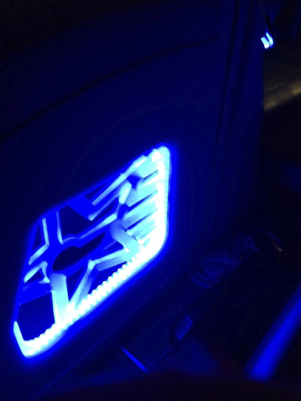

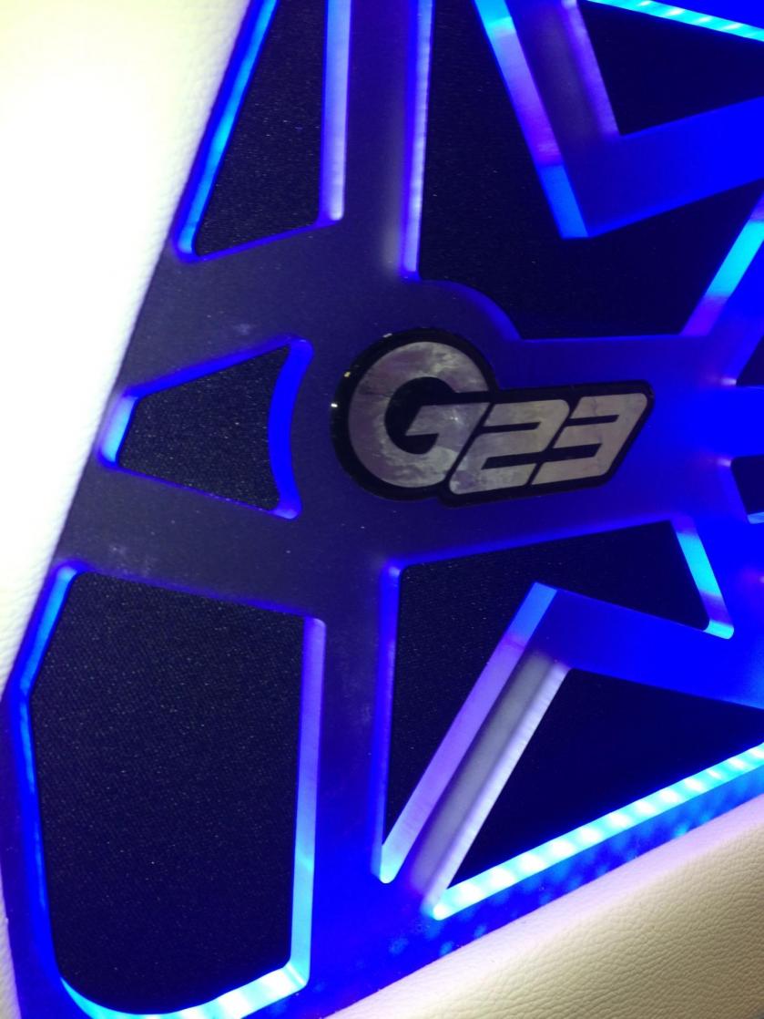

    Thought I'd show a pics of my new system in a G23. Spade Kreations in Cincinnati, OH did an incredible install and turned it around in less than two weeks. I'm convinced they are one of the best fabricators in the country after working with them on this. It's incredibly clear, loud, and hits hard - I found myself tightening hardware at the end of last weekend. The lock on the glove box completely fell off and the rear vents were all loose and it was only its second weekend on the water. Gonna need to keep Loctite around with this system. They originally made a ported box right out the vent but it wouldn't load right, so they remade it to fire to the back of the boat and it sounds great. They also did a custom plexi grill and EQ mount and added LEDS throughout.
    Brief rundown of the system:
    2 SD6 (585X4 to Tower, 290X2 to back in boats, 185X2 to front in boats)
    1 SD2 (1250 to sub)
    4 Rev 10s w/ swivel mounts and LED Rings
    XS-650 RGB (In Boats)
    1 XS-XXX in ported box tuned to ~ 36 HZ (that long thing extending out from the sub is a long port)
    WS-420
    2 8D Batteries (In rear lockers for extra ballast!)

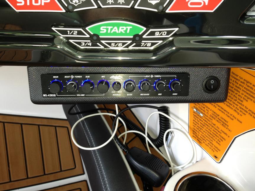

                Where did they mount the WS 420? More pics please!!!
                • imoveteeth
                  • Jan 2013
                  • 16
                  • Mason, OH
                  Sorry haven't been on in a while. Under the dash in a custom enclosure...Click image for larger version
