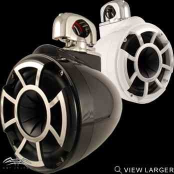

        These are the clamps I have, I'm not sure if they are the X or the fixed position clamp. Nothing was recovered, I would imagine that when it dropped off it hit the cover and trampolined into the ditch. I had my brother-inlaw watch for it when they came through, but they didn't see anything. I double checked the other speaker when I made the discovery, and it's tight.

          When I installed mine, I believe that there were several length bolts (for different diameter towers). It is possible that your installer used too short of bolts. I'll check mine tonight, but I don't think mine have loosened up at all since installing late last year, and I have trailered the boat a number of times since then. That said, I might put some thread lock on now.
          This might be what they did, it makes sense, like i mentioned above everything seemed tight when I was putting the socks on, as you do have to tug on them a bit to stretch the socks on. as soon as I get home, I'll be getting out the 'ol blue threadlock as well. Could be an expensive ticket if they don't cover it.
