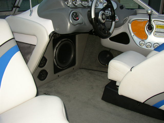

                  I'm picturing something like this...
                  I know I have some obstacles (water and ballast hose's need to be lenthened, wire's re-routed perfect pass moved, fuse block moved and all while not cutting into the factory wire harness), but I don't have a heater or gas fill lines in the way, and I feel like the enclosure will be almost identical in size to my existing one under the observers seat, which is ported.
                  David, I'm assuming that whatever sub I decide to go with will dictate how many cubic feet the enclosure should be, correct?
                  For example, say I decide on the Wetsounds XS-XXXv2.
                  This sub calls for-
                  1.2 cubic ft SEALED enclosure or 1.78 cubic ft PORTED enclosure.
                  What exactly would be my best option here?

                      I took the carpet off the existing kick panel and replaced it with 3/4" mdf. I then built a box 8" deep 13" tall and 24" wide. But it is shallower toward the starbord side of the boat. Fits fine and shakes the crap outa the boat.
                      Is is on a 97 super sport. The kick panel does not go all the way back to "stock" position but its good enough for the girls I go with.

                        Great results Brichter! Does the fuel fill line run right behind that kick panel in a 97? I'm guessing that is the main reason it is offset to the left? I love the way it came out and may copy your design when I get around to it.
                        Shawn
                        2012 Blue Metal Flake SAN 230
                        • Brichter14
                          • Jun 2013
                          • 531
                          • Central Illinois
                          Ya there is a wiring harness and fuel lines back there. I tucked them to the right a bit but they still prevent the box from moving all the way back to the original position
