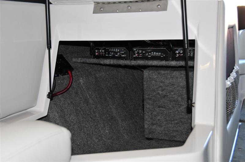

            The most logical place to put the sub in the observer seat compartment...and it has to be vented outside that compartment or it will sound bad.
            For a DIY build, radiating directly outside the observer seat compartment will be hugely difficult unless you have good woodworking skills and the right tools. Most put the sub box in that location but then vent the observers seat area by cutting the base support of the seat and/or cutting the walk through area.

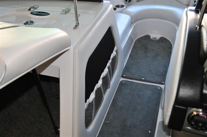

            For mine, I vented the walk through by cutting 6 x 5" holes using a hole saw. I then covered it with speaker cloth with a foam backing to keep the cloth from flapping around (I cut matching holes in the foam so it wouldn't impede airflow). I used foam wrapped in speaker cloth on the inside of the compartment to give that area a finished look. The upside of this solution is it's very easy to do and looks like it could be OEM. (The photo shows a sealed sub box...I subsequently changed it to vented.)
            I have a Wetsounds XXX, but I think any decent sub with enough power will work. As a general rule, the smaller your amp, the smaller you'll probably need to go wrt the magnet. Don't pay for a "competition" sub and then try to drive it with 500w. Look up the specs for your sub and match the amp to that. Frankly, the stock sub can sound very good if it's in a good box and is powered to spec.
            Ported/vented box v. sealed: both can sound good. When I went from sealed to vented, I noticed the roll on/roll off seemed to be more extended and it hit a bit harder. Nevertheless, the sealed sounded good and took up quite a bit less room.

              I have got a local stereo guy coming next week to wire in what I have already. He tells me he has an airblade for making the vent in the walkthrough, sounded like a better option than a saw. Anyone familiar with that?
              He is also bringing a selection of subs so we can see which ones sounds the best in that compartment.
              When mounting the amps in the locker is it cool to just screw them into the port side there in the factory place or do they need a backing board?
