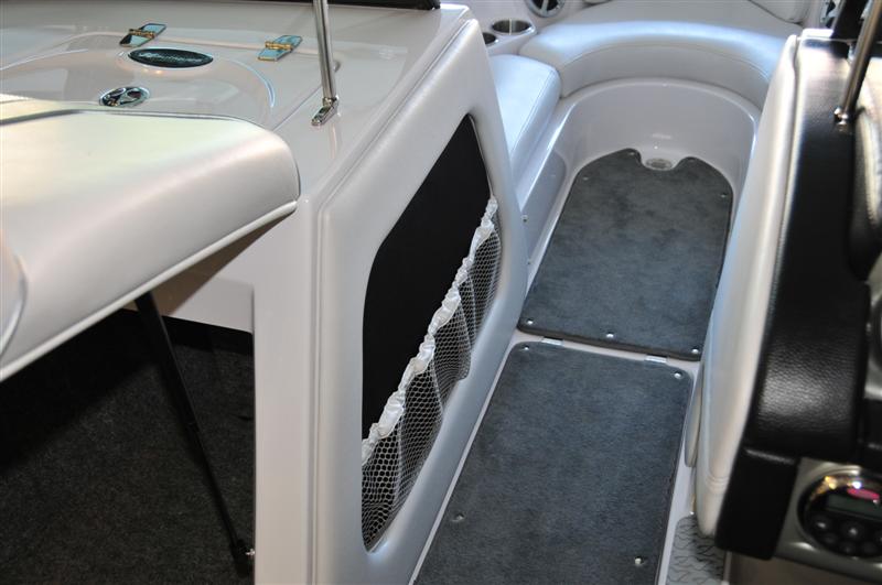

      I don't have photos of them. They are behind the black panel in the photo. I cut three across the top of that area and three across the bottom.
      The panel is made out of foam covered in speaker cloth. I cut out matching holes in the foam so that the foam would not impede airflow. When the sub is hitting, you can see the fabric move where the holes are cut.

        Gotcha. I was having a hard time visulaizing the holes...the fabric looks great.
        Its hard not to think the more access the better, so the bigger and/or more holes, the better the sub can radiate bass and music tone accurately with least distortion and obstruction. My opening is roughly the size of yours with a plexi insert.
        I can tell you that sub orientation matters.... my sub sounds better oriented towards the hull vs firing directly out the hole into the walkway. I heard it both ways... sounds deeper, more solid and seems to resonate throughout the boat more evenly toward the hull vs walkway for me.
