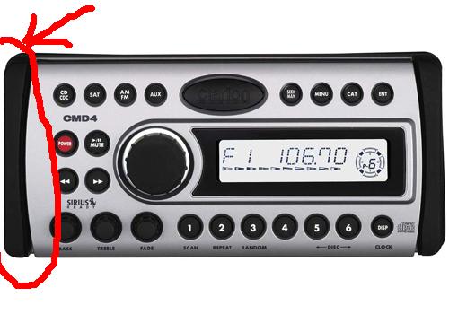

    In 05, it could have been either an XMD-3 or a CMD-4. Are the remotes round or oval? The round remotes were released about the time the CMD series launched. Also, you can measure the bolt hole spacing for the head-unit. The XMD and CMD units had different footprints.

        The 2005 SANTE has the Clarion XMD3. I have just replaced my XMD3 with a CMD6. MLA is correct regarding the foot print....What a pain to convert the setup. I have my XMD3 that came out of my 2005. My XMD3 worked when I purchased the boat, but after the first interior wash job, it never worked again. I checked the fuses, power, ground, everything checked good. So I upgraded to the CMD6. I could not find another XMD3 when I started this task. If you want my old XMD3 PM me. I got the remote too.

                  The XMD offsets the 2x7 chassis slightly to the top, and the CMD offsets the 2x7 chassis slightly to the bottom. This means the CMD replacement could have a clearance issue with the glove box lid. Not to mention the outer screw hole location differences.
