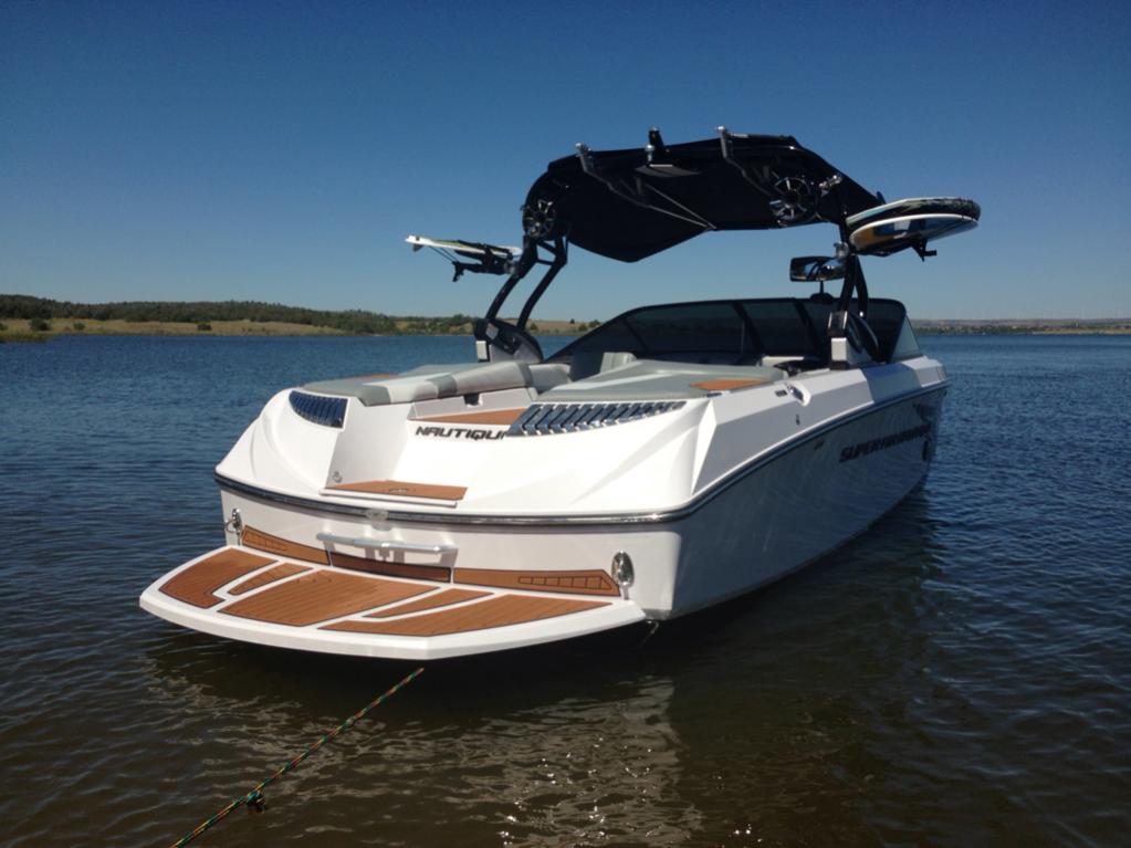

      1 pair Rev10s on a clean true 400-500w ea will satisfy 95% of folks.... And look good doing it. Flip the board racks upside down and they tuck tight up into the corners like this out of the way to preclude any head bumping ....
