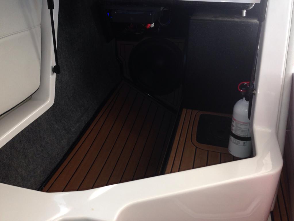

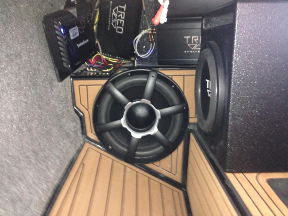

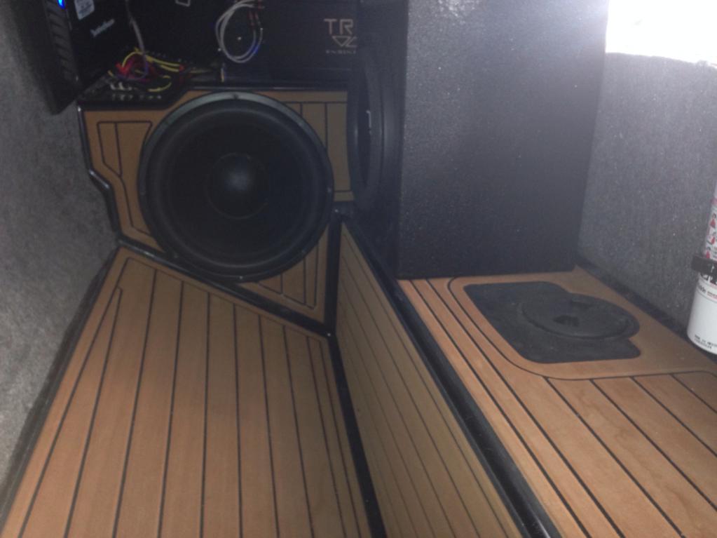

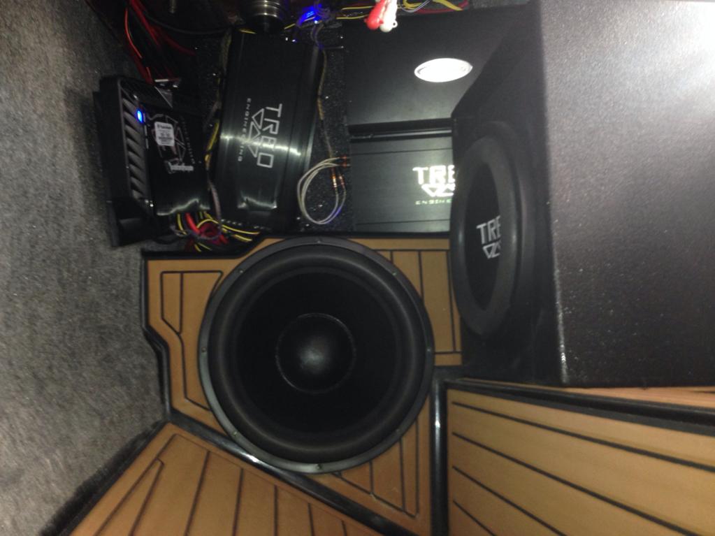

Team- thought I would share a recent project on my G that just turned out great. Upgraded the stock 10" Polk on 200w to a 15" Fi Audio IB3 on about 550w. It's an infinite baffle sub. That is in addition to a ported Treo 12" on 1500w.... That I had in there first with the 10" Polk just disconnected, and considered the 12" needing a little more.
First, I wanted huge sound.... At a budget.... And absolutely not give up ANY storage space anywhere, as I store big surfboards and such down there, and want to maintain a clean un-intrusive install. I love the over the top stereo setups... But not for my budget or the way we use our boat.

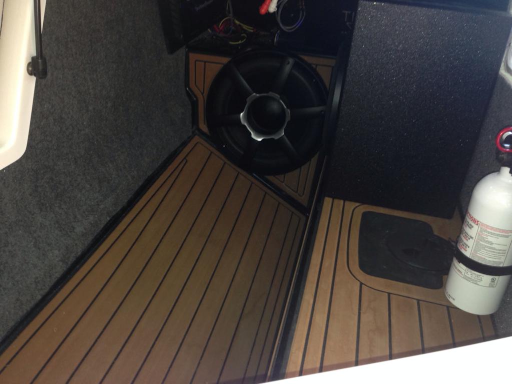

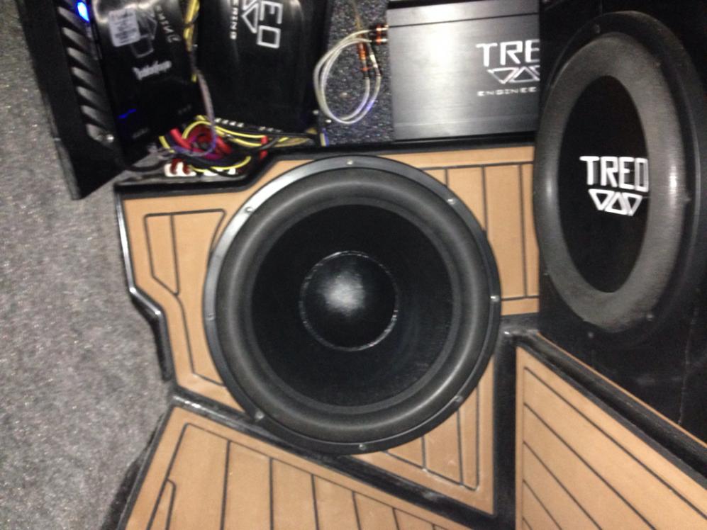

Going in to this I can say it was a leap of faith. I had never heard an IB sub in a car or a boat I would consider due to poor sound quality and weak performance. Other than modest mid bass...Most sound thin, weak and weazy. Low freq's are embarrassing. The IB3 was the biggest heaviest IB sub I could find.... Without getting into the insane home theater stuff.
Listening to this with the 12" unplugged I was thoroughly impressed with its sound quality. Lots of sub travel and excursion, move a lot of air, Sounds like it's mounted in a 1" thick solid MDF tuned box. Sounds solid. Sounds deep. Tight bass. DEEP bass... Deep bass that travels, perhaps deeper than the ported 1500w Treo. Very impressed. Together, they straight hammer.

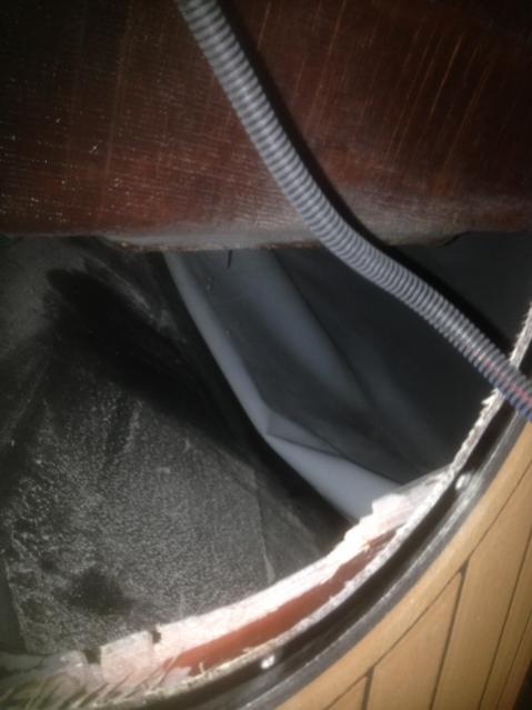

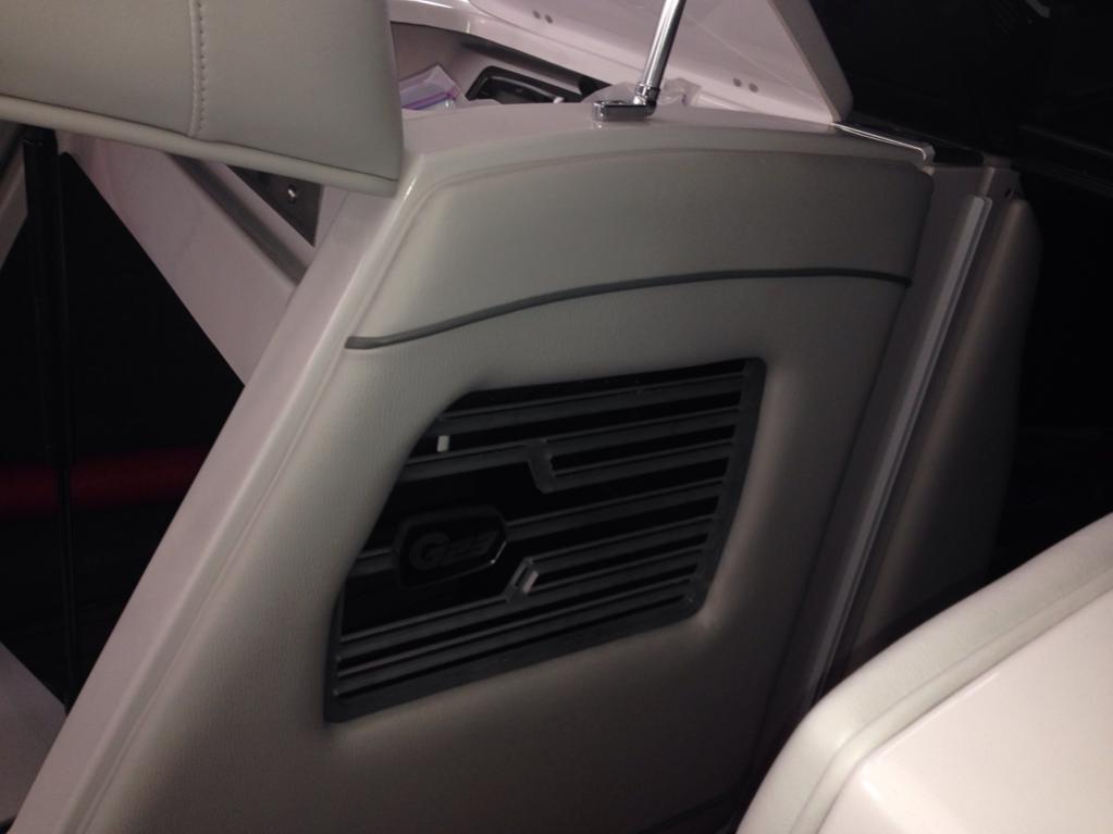

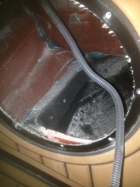

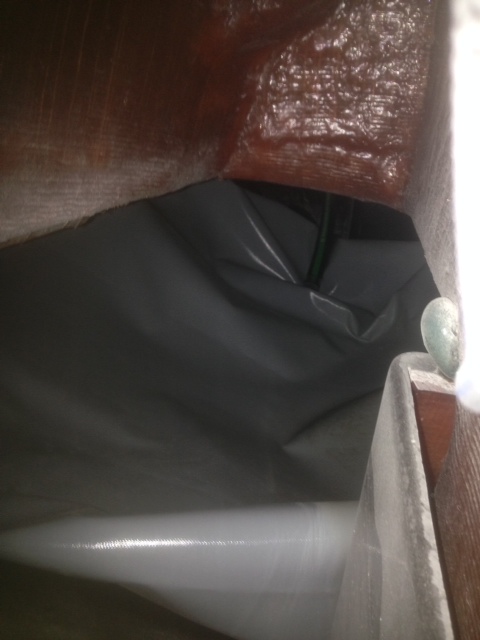

I do have a vent cut into the walkway to assist in letting the bass radiate. Of course, fiberglass had to be cut larger to fit.
But what I will pass on is for those looking for a solid sub upgrade over the 10" Polk..... Without loosing storage...Give this a strong look. I will upgrade the amp it's on to around 750-850w at 2ohms. The 550w I have it on now isn't enough, can definitely handle more.
