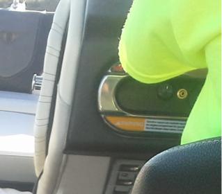

    We used his in my boat a few times and it worked great, I just wanted another option for controlling the volume than diving into the link every time or finding the phone. I added the Wet Sounds bluetooth volume control, and it lets me easily change the volume and track or pause the song if I need to hear something right away. The only thing I wish was better is the speed of the volume changing it takes about twice as long as I wish it did. Its the knob in the storage area next to the video input jack.

          Auto volume is a great feature that would be better if it had a more aggressive setting. On the highest setting it does not bring the volume down enough to communicate with the rider so I augment it with my volume control. The way I use it the link volume is set to 32 at 23mph and I use the BT VC to turn the volume down the rest of the way or pause the song. The mute option in the link never worked for me since it unmutes itself at exactly the time I am circling the rider if there is any current or wind.
