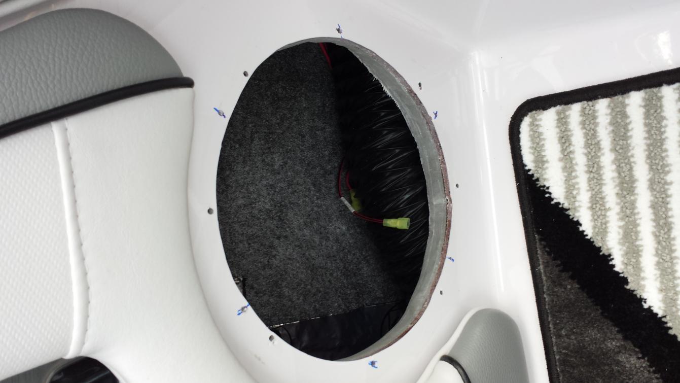

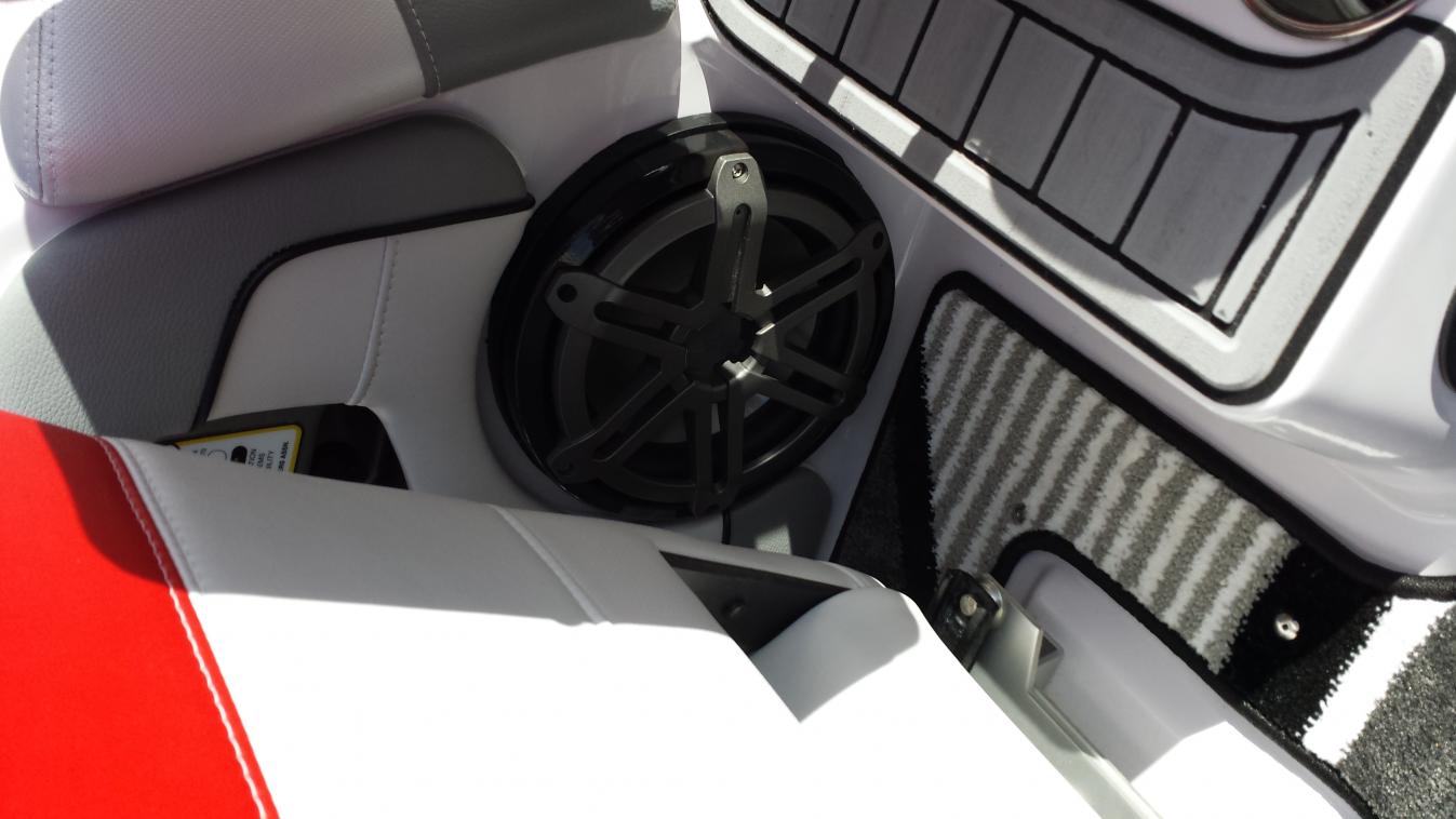

      Indeed. I used the trim ring on the outside (gave the sub 1" clearance to side of the hull) used some sound deadening material in the panel. I did not take the panel apart I simply removed the seat and removed the 6.5" speaker that was there and placed the deadening material where I could reach. I added a couple of photos to show how Nautique added fiberglass to where the sub mounted, and I painted the ring black (I will black vinyl cover it this fall). Foe those thinking of this sub change I recommend it a great deal. I am using a bit more power than the stock sub but what a difference. For the record I am only using 300 watts. Now to make this Rev 8 sing!!Click image for larger version

                I'm impressed on the amount of fiberglass behind your speaker. Should you still put the trim ring behind the speaker ?? That looks very sturdy
