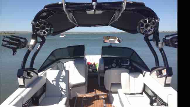

    Flip your racks upside down and use the swivel clamps for this setup. Absolutely the tightest out config you can do for a single set of Rev10s. Only drawback is you can't have boots up in the top rack, boots go down in the bottom racks. 1/4" clearance when you swing the racks in from the Revs. No chance of head bumping like this.

      I want to be able to rotate with boots in the top rack...I rarely surf, so we always have 3-4 wakeboards with boots. If I do it like yours, I'll lose all swivel ability

        Correct, you can still put them in there... You just loose the full 180deg swivel... To more like a 120deg swivel. You can't swivel them in far enough to lock the racks in place.

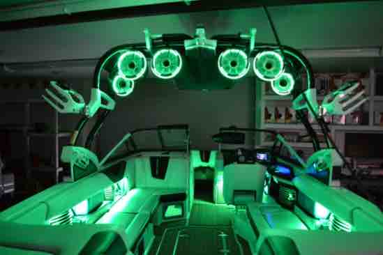

          Here is another config. 2 pair Rev10s and a pair of Rev8s.
          2019 G23 450
          2014 G23 550
          2013 G23 450
          2011 Malibu Wakesetter 247
          2007 Yamaha AR210
          • nyryan2001
            • Mar 2013
            • 1993
            • Lake Anna
            That middle pair ^^^ is what I want to try to add to mine above flush mounted as you see here in green.... However MLA says it's not possible.
            We'll see here shortly.
